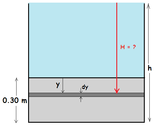

Lets start with the easy part:
The pressure of the air is constant so the pressure will act as if it's a concentrated force on the center of gravity of the gate.
F = PA = (10,000Pa)(.3)(.6)=1800N
The moment about B = 1800N (.15m) = 270Nm.
Now we know that the water has to exert a 270Nm torque to make the gate move.
This is where I'm stuck. I'm not sure how to find the torque that the water exerts on the gate. Depending on the ratio of h to the height of the door, .3, it seems to me that the concentrated force of the water might land above the door. So it seems to me like I can't use the same method. I feel like I need to integrate and add up all the small moments across the whole door.

OK. You have the right idea. If you let y denote depth below point B, how would you express the force from the water on a horizontal strip of the gate if the strip extends from y to y+dy?

From the picture below, what is the depth, H, of the strip below the surface of the water in terms of h, y, and .30 m?

H= h + y - .30
Feodalherren said:
H= h + y - .30
Yes. So, you can express the force on the strip in terms of H, and therefore in terms of y and h.

Ok so dA= .6 dy
The force exerted by the water on a differential of the area is
Fw = P(.6)dy
The pressure of the water:
ϒ = 9790 N / m^3
P= ϒ(h+y-.3)
then the force becomes (ignoring direction since we know it's opposite to the direction of the force of the air).
Fw(total) = ∫ ϒ(h+y-.3)(.6)dy
integrate from 0 to .3
is that correct?

OK, I guess you're using 9.79 m/s2 for g.
is that correct?
This would yield the force, but you want the torque.

Yeah I just wanted to check my logic. Okay so if that's the total force then the total torque must just be the total force multiplied by the distance
T = F y
where y is the distance from B to the point of application of the force.
so
T = ∫ ϒ(h+y-.3)(.6)y dy
correct?
Looks good.

Thank you so much! I got the correct answer!
