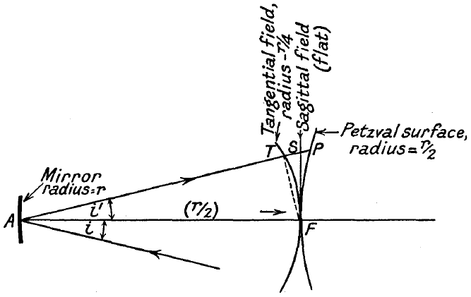

I am currently studying with full-wave simulations the focusing properties of a 2D parabolic mirror, i.e. the scattered fields resulting from plane wave incidence at oblique angles.
What I observe for shallow reflectors is that the maxima of the scattered field generally lie on a curve that bends towards the reflector for increasing angles of incidence, just as the tangential focal surface shown in the attached figure.
243253
What I learned for the 3D case (paraboloid mirror) is the following:
- As every optical system, the mirror has associated with it a sort of basic field curvature, called the Petzval curvature. When there is no astigmatism, the sagittal and tangential image surfaces coincide with each other and lie on the Petzval surface
- The sagittal focal surface from third-order Seidel aberration theory is the focal plane, and the tangential focal surface lies between the focal plane and the mirror
- As in any optical system, the tangential surface is three times as far from the Petzval surface as the sagittal surface
Now my question is, how can the focusing contour that I observe for the 2D case (obviously astigmatism is not defined in 2D) be explained with this/third-order aberration theory?

I'm not entirely sure what you are asking- for one thing, you seem to be mixing ray (third-order aberrations) and wave optics models. Are you asking how aberration coefficients are computed in general? Are you asking how parabolas are handled in wave optics? Are you asking for detailed computations of aberration coefficients for a parabolic mirror?
The largest off-axis aberration of parabolic reflectors is usually coma, not field curvature:
