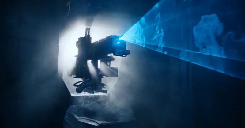

You could also consider scanning a 1D beam in a plane faster than your shutter speed or the rain drops. This may be easier. Something like a reflection off of polished faces of a hexagonal nut (the mirrors) mounted on a motor shaft. You may have to fiddle with aliasing issues depending on the speeds.
Yes, planar-scanned lasers are often used for special-effects in movies. An example is this shot from the opening of Aliens, where a robotic drone searches for Ripley in her cryo-chamber:

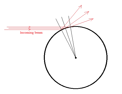

Here's my 5 minute experiment.
You might experiment with fanning out the beam by reflecting off a smooth cylindrical surface. Here, I used a ceramic mug.
That is interesting. How much light do you think gets absorbed by the mug? I wish I could visualize how that happened. Looks like you reflected 90 degrees off of it?
I don't know. A highly reflective metal surface or mirror would not absorb very much.
Each ray of light in the beam obeys the law of reflection at the curved surface.

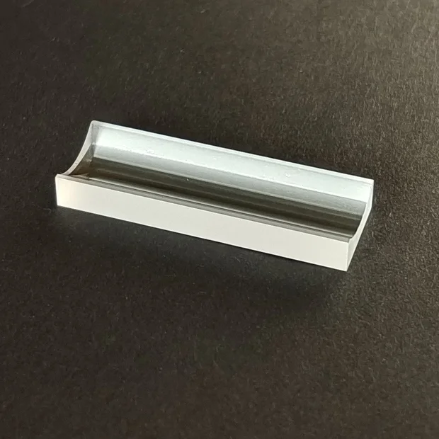

I initially got a cylindrical lens on Amazon for under $8. It didn't work at all.
Just any old concave lens will not do. I saw several versions of the same on eBay thing so they are clearly for a particular purpose.
is this the sort of thing they delivered? (eBay ad)
But seriously, why not go for a cheap laser level?
A fan-out will reduce / eliminate the risk of eye injury by a massive factor.
The one I got was half a circle so flat on one side and convex on the other. Is the version in your picture what I'm looking for?
OK; that's the definition of a Plano Convex lens but you need a concave lens to spread the beam. There are hundreds of links showing ray traces of all common shapes of lenses and reflectors. Do a bit of research with terms like basic lens and ray diagram. It has taken 29 posts to get down to the real problem. Try not to waste people's time and do a bit of self-help before trying PF. Failing that, at least post a diagram of what you are trying to achieve.
