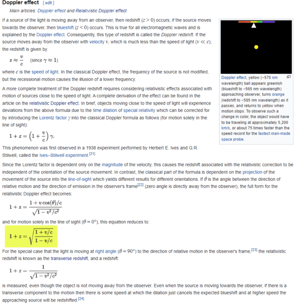

Are you referring to the equation in yellow below?
That is just a trivial rewriting of what I gave, yes.
