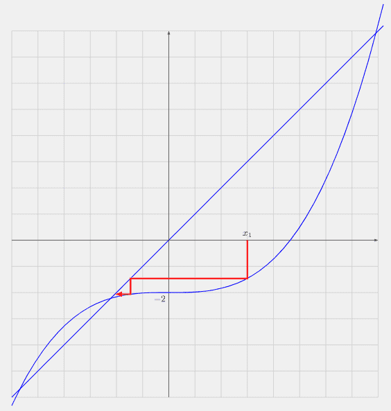

Hey! 😊
For which values of $a\neq 0$ can we solve iteratively $ax^3-x-2=0$ by $x_{n+1}=ax_n^3-2, \ n=1,2, \ldots $ with appropriate $x_1$ ?
I have done the following:
$$ax^3-x-2=0 \Rightarrow x=ax^3-2$$ So we can consider a fix point problem with $\phi (x)=ax^3-2$.
So we have to check when the fix point iteration converges right?
For that $\phi$ has to be Lipshitz continuous, or not? :unsure:

Hey mathmari!
Isn't it the other way around?
If a function $f$ defined on the real line with real values is Lipschitz continuous with Lipschitz constant $L<1$, then this function has precisely one fixed point, and the fixed-point iteration converges towards that fixed point for any initial guess $x_0$.
So we can only use that to prove that if $a$ is on a specific interval, and if the Lipschitz continuity related criterions are satisfied (perhaps on a sub domain), that we have a converging sequence, can't we? 🤔
We can check for which values of $a$ we have that $|\phi'(x)|<1$ at a solution $x$.
I believe that is the case for $-1<a\le\frac 1{27}$.
We can also verify that for different values of $a$ the algorithm diverges. 🤔

I made a couple of drawings for $a=0,1,-1$ and for $a$ positive/negative and close to zero.
And I considered how the algorithm would progress.
Consequently I discovered a couple of edge cases and calculated where those edges were.
Consider for instance the following graph:

In this case the sequence converges, doesn't it?
What would the edge cases be? 🤔

Here is a PNG version of the picture:
As you can see, the algorithm converges to the fix point where the slope has magnitude less than 1. That is, where $|\phi'(x)|<1$. 🤔

mathmari said:
Can we see that only using a graph?
The graphs are to help us understand what is happening and what the relevant edge cases are.
We know now that it matters for $a>0$ if we have 1, 2, or 3 fix points.
Note that if $a<0$, then $\phi$ is decreasing, which means we have exactly 1 fixpoint since $x\mapsto x$ is strictly increasing.
If we have 3 fix points (which implies $a>0$), can we prove that $|\phi'(x)|<1$ at the middle fixpoint? 🤔
If so, then we can apply the Lipschitz continuity criterion to an interval starting at the middle fixpoint and conclude that the sequence converges.
When do we have 2 fix points? Can we find at which value of $a$ that happens?
Can we apply the Lipschitz continuity criterion then and conclude convergence? 🤔
If $a<0$, then we have exactly 1 fixpoint.
What can we say about $\phi'(x)$ at the intersection point? Can we find when it is $-1$? 🤔
