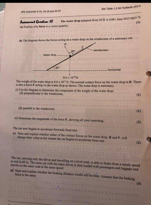

I am helping someone with her homework and need help with part C.
I have attached all my working.

Yes, the wind will exert a horizontal force, and R may also change.
You will need to make some assumption about the nature of F to decide whether that will change,
You also know that the drop stays on the windscreen, which gives you information relating the acceleration of the car to the acceleration of the drop.
