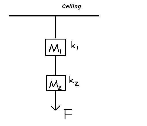

A pair of masses M1, M2 is suspended vertically by a pair of spring, with spring constant k1, k2. ( see the attachment for the picture)
a.A downward force F is applied to bottom mass. Find the downward displacements d1 and d 2 of the equilibrium positions of the Mass M1and M2 due to the force. Note that effect of gravity is already taken into account in determing the equilibrium positions.
b.At time t =0, the downward force is removed. What are the equation of motion and initial conditions that determine the displacements d1(t) and d2(t) for t greater than 0? You need not solve the equations.

For A, try creating separate free body diagrams for [itex]m_1[/itex] and [itex]m_2[/itex] and finding [itex]\Sigma F_y=F_{app}[/itex]. Then, solve each for [itex]d_1[/itex] and [itex]d_2[/itex].
a) Both springs will experience force F. Since they are already in equilibrium you can "ignore" the masses.
[tex]F=k_1d_1[/tex]
[tex]F=k_2d_2[/tex]
b) Simple SHM equations.
