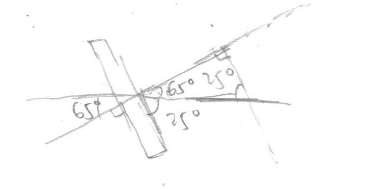

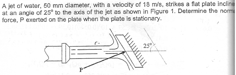

A jet of water , 50mm diameter , with a velocity of 18m/s , strikes a flat plate inclined at 25 degree to the axis of jet as shown in figure, Determine the normal force , P exerted on the plate when plate is stationary .
Hand-drawn sketch of a jet striking an inclined flat plate, with angle labels 25° and 65° marked between the jet direction, the plate and the plate's normal.
in the diagram attached , i found that the angle between the water velocity make an angle of 65 degree to the normal of the plate ,
so my ans is F = ρA(v)(v cos theta) = 1000(pi)( [(50x10^-3) / 2 ] ^2 ) (18^2)(cos 65) = 278.7 N , is my working correct ? i don't have the ans
  • Diagram of a water jet from a nozzle striking a flat plate inclined at 25 degrees to the jet axis, with the normal force P shown as an arrow acting on the plate's underside.
Your algebraic expression looks right but I don't get same answer (about 4% less). Check your arithmetic.
my ans is 268.8N
