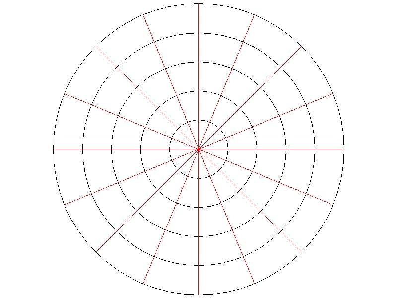

There is a contact zone between the bottom of the tyre and the road . Make the approximation that this zone is circular and that the steering axis goes through the centre . Make the further approximation that the wheel load is uniformly distributed over the contact zone .
Divide the contact zone into several nested annular sub zones . Work out the friction torque for each sub zone and sum to get the total friction torque .
It is easiest to use a relatively small number of sub zones and get the answer numerically but you can use calculus if preferred ..
Thus is essentially the same procedure as used to work out the load carrying capacity of clutch plates .
I'm with you until this point, Nidum. Why annular, instead of rectangular or even a line?
It comes from dividing the contact zone into many segments using concentric circles and equally spaced radial lines .The torque contribution from each segment is then very easy to calculate . It turns out though that the number of segments per annular ring cancels in the calculations and that the basic annular subzone dimensions are all that is needed .
Circular sub division is easiest because of the assumed circular shape of the contact zone ..

With the sparse data available there is no way of determining the exact shape of the contact zone or the distribution of load over the contact zone .
Assuming a circular contact zone and uniform load distribution does allow an approximate value for the steering torque to be obtained .
There are more complex versions of the basic calculation using rectangular or elliptic contact zones and load distribution based on an empirical rule . There are also more comprehensive analytic solutions and linear and non linear FEA .
For the present purpose though the circular contact zone model is the best that can be done . Calculate a value . Multiply by a safety factor for design purposes .
For a given load friction torque in this type of problem is not usually very sensitive to small changes in contact area or contact geometry . A good estimate of the contact area and the assumption of it being circular does actually give reasonable answers in most cases .
This is for reasonably rigid wheels with solid rubber tyres or properly inflated pneumatic tyres .
I'll add my usual rider though - it's many times easier to do a practical test with a real wheel .
