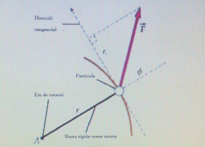

[QUOTE="haruspex, post: 6059313, member: 334404"This is correct, but it is unclear how you arrived at it. What if the wheel were a uniform disc?[/QUOTE]
Before I do the proof of the formula.
To demonstrate the equation of Newton's second law to rotation, we will base ourselves on a drawing.
Formed by a mass particle m attached to a rigid bar of length r and too insignificant and to a rotation axis. Therefore the particle moves in a circle of radius r. On the particle a force vector(F). is applied. It only works in the tangential direction Ft. With the second law of Newton you get it
Ft=mat
where Ft=F·sinφ and at is the tangential acceleration. We have that at=rα where r is the rigid bar, which is equivalent to the radius of the circumference and α is the angular acceleration, therefore:
Ft=mrα
We know that the moment or torque Γ=rFt and to be able to replace we have to multiply the radius r on each side
rFt=mr2α → Γ=mr2α
A rigid object that rotates on an axis (the wheel of the bicycle) is simply a set of particles that are forced to move in a circular and at the same speed. Applying the equation prior to the particle and the set, it remains
Γi net=miri2α
where Γi net is the torque of the net force on particle i. If we add the rest of particles, the terms of the following expressions are obtained
∑Γi net=Σmiri2α=(∑miri2)α
and if we replace the moment of inertia, but we know that I=Σmiri2, it is:
∑Γi net=Iα
and taking into account that the sum of forces of the particles is equivalent to the net external force that acts on the whole set, the formula of the second Newton law is obtained at the rotation:
Γnet ext=Iα
  • Diagram of a particle on a circular path attached to a rigid massless bar of length r pivoting at axis A, with force F applied at an angle phi to the tangential direction, decomposed into components F_t and F_r.
