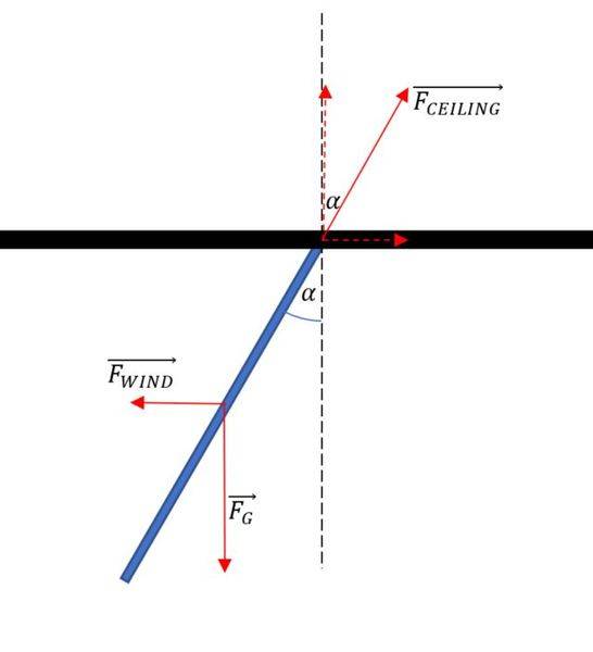

Well, everything I know about ##F_{ceiling}## is that it is the only force acting on a foil besides ##F_{wind}## and ##F_g##. Its ##x## component ##F_{ceiling X} ## must be equal (size) to ##F_{wind}## and ##y## component ##F_{ceiling Y} ## must be equal (size) to ##F_g## in order to satisfy forces equlibrium. It is obvious then that the angle is the same. We really do not need to talk about torques here.

##F_{wind}= m \cdot g \cdot \tan{\alpha} = 0.00056## ##kg## ##\cdot \tan{17 °}=0.000171## ##N##

Acceleration doesn't come into play here. This is a static equilibrium free-body analysis. The weight of the foil should be written out to only 2 or 3 significant figures to match the precision of other variables. The point of application for the aerodynamic force will be a little above the centroid of the foil due to endplate effect and tip losses, but a fine point which I'm sure is not worth worrying about.

CWatters said:
I'll have to think about that. The angle of the reaction force at the ceiling isn't know
Handy rule: if three forces are in static equilibrium they must act through a common point. But...

Yes, it follows from the torque equilibrium. It cannot be proved otherwise.

I do not understand why we need to talk about torque equilibrium. What is wrong with my deliberation:
I know the angle, I know the ##F_g##, I know the direction of ##F_{wind}##. There should be one more force to satisfy the forces equilibrium. I call this unknown force ##F_{ceiling}## ...(read the quote below)

Suppose instead that the hinge has some frictional torque. Now the angle of the reaction force cannot be in line with the plate. So your assumption that the angle is the same must effectively be using a torque balance equation.

I know the direction of Fwind.
You know the (free stream) direction of the wind. The presence of the foil is going to change it. The component of aerodynamic force parallel with the wind is drag, but you also have a perpendicular force component (lift).
