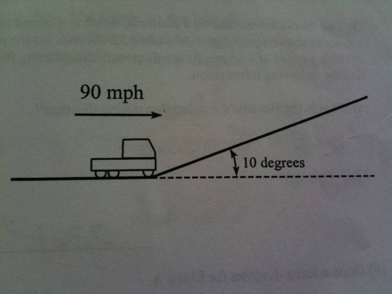

A runaway truck with a mass of 10,000 kg reaches an emergency pullout ramp moving at 90 mi/hr. As it plows through the deep sand spread over the pullout, it experiences a frictional force of 5000 Newtons opposing its motion. How high up the ramp will it rise?
Note that 1 mile=1609 meters.
So far I've only converted 90 mi/hr to 40.23 m/sec.
I'm totally confused on how to go about solving this problem. Maybe the fact that the ramp at 10 degrees is throwing me off?

Have you done conservation of energy in your physics class yet? Or just kinematics and Forces?
Yes how would you use Energy Conservation to solve this?

Yes to the all KE in the beginning, but as the truck goes up the ramp it loses KE and converts it to U or PE. If it says the highest the truck rises, this implies the truck comes to a halt momentarily or not. If it was not at its highest it would be moving back down or still moving up the ramp. Now this all assumes the ramp is frictionless. But you are also going to lose some energy to friction.
So do you know the equations for gravitational potential energy and Kinetic energy? And do you know the work friction is performing on the truck?

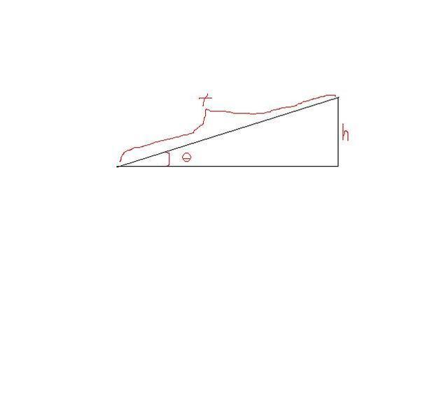

Just .5mv^2 at the bottom... and mgh and the work done by friction and given off as heat This picture may help you relate X, distance up the ramp at an angle theta and h... I think this route is easiest the way you are thinking.
Hand-drawn sketch of a ramp as a right triangle with angle theta at the base and vertical height h on the right side, with a red freehand curve drawn along the incline and a small tick mark near the top.
In other words, all the Kinetic energy of the truck is converted to gravitational potential energy and heat.
How would I even find x (the length traveled up the ramp) or the height, h, as shown in your picture when all that was give is the angle of the ramp to be 10 degrees?

So right now we have m, g, h, v, theta, x and the force due to friction. Out of all of these you know m, g, v, theta, force due to friction. The only things missing are the distances, h and x. But h and x are related. I think you might be able to put h in terms of x. Then there will only be one variable, x. This is what you are looking for I believe. I am calling x the distance the truck travels up the ramp based on my picture.
In my picture I am using the force of friction and X as parallel to each other so no need for cosine.
0.5mv^2 = mgh + F*x
So put the h in terms of x and solve for x.

Using your numbers... I did not go through changing mph to m/s etc..
0.5(1000)(40.23^2) = 1000(9.8)(sin 10)*x + 5000*x
I put h in terms of x... sin 10 = h/x by my picture...
