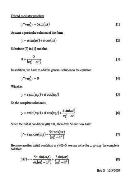

I think that if the shaker acceleration, and not the amplitude, is fixed, then you will get beat frequencies between the shaker frequency and the natural resonant frequency ω0=sqrt(k/m). See the thread

In this thread, the particular solution was for a constant sinusoidal driving force. The beat (difference) frequency is a dominant feature of the amplitude in this solution.

Comment on my previous post. In my second of three attachments, I derive the solution for a harmonic oscillator driven by an off-frequency force (acceleration). My solution is for the undamped case. The particular solution (Eq(3)) is the steady-state solution (w/o damping). Eq (8) is the complete solution, where the first term matches the initial conditions to the steady state. They are:
1) a(t) = (F/m) sin ωt (so the forced acceleration is zero at t=0 (when it is turned on);
2) y(t)=0 at t=0; and
3) y'(t)=0 at t=0 for same reasons.
There is no remaining beat frequency after the first term in Eq(8), for matching the initial conditions, is damped out.
