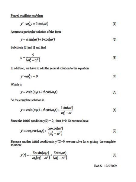

If I have a force that is pushing upwards on a spring-mass system, and I basically have to find an equation that will give me the velocity and y-position for any given t, how much does that differ from the general form of Asin ([tex]\omega[/tex]t +[tex]\phi[/tex])?
This is what I know:
m= 2
k= 32
Vertical position y of mass: dy/dt = v
Velocity of the mass: dv/dt = f(t)/M - (k/M) * y
I know the external force is f(t) is 10sin([tex]\omega[/tex]t)
I know that y(0) and v(0) are zero.
I have to find the position and velocities when [tex]\omega[/tex]= 2, 3, 3.5, 4, 4.5, 5 rad sec and I have to use 40,000 time steps (totaling 25 seconds) where each step is 0.000625.
I know that the "preferred" frequency of the system will be at 4 rad/ sec, using [tex]\omega[/tex]= [tex]\sqrt{\frac{k}{m}}[/tex]
This is where I am having a bit of trouble: I found that when I'm examining 2 rad/sec, that v'' = 5cos2t - 16y', or that v'' = 5cos2t-16v. What I'm trying to do, is find the velocity and position of this system for any given value of t.
I was told that I can use the "general" solution of this type: v= A cos 2t + B cos 4t + C sin 2t + D sin 4t.
Am I in the right direction? Any insight would be appreciated. Thanks in advance!

Isn't sqrt(k/m) fixed at sqrt(32/2) = w0 = 4 radians per second?
Isn't your differential equation
y'' +w02y = (10/m) sin(wt) [STRIKE]- g[/STRIKE] where the right hand term is the driving term?
where w0= sqrt(k/m)
Note that the units on the left hand and right hand sides have to match.
Bob S
Hi gramentz-
Look at the thumbnail and see if it fits all conditions, including driving force and two initial conditions.

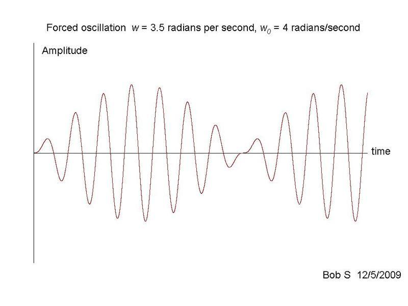

[added] Here is a thumbnail plot of the solution using w=3.5 radians per second, and w0 = 4 radians per second. Both the amplitude and derivative are zero at t=0.

When we assume the general solution of the form y= csin(w0t) + dcos(w0t)...is this because all of the derivatives will take such form? Since dy/dt = v in the original equation I was given, that implies that step 7 in the thumbnail could also be v(t)? Thank you for helping me with this.
Hi gramentz-
The particular solution provides the long-term (steady state) solution to match the driving force, especially when there is damping. But the particular solution does not match the initial conditions; specifically y(0) = y'(0) = 0. To do this, we need a solution to [4] with two arbitrary constants that can match the particular solution [1-3] to the two initial conditions. So that is why a general solution of the form [5] was chosen. The final solution [8] matches the two initial conditions at t=0, AND the particular equation [1] at all times.
Bob S
It took me quite some time, but I finally understand what you wrote and how you arrived at your answers. Thanks for taking the time to help me out, I appreciate it.
