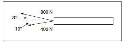

Two tugboats are pulling on a large log, as shown in the following diagram. The log has a mass of 250 kg and is initially at rest. How far have the tugboats moved the log after 10 s?
c2 = a2 + b2 - 2abcosC
c = (a2 + b2- 2abcosC)1/2
[/B]
c = [(400 N)2 + (800 N)2 - 2 (400 N) x (800 N) cos 150°]1/2
c= 1164 N
sinβ/800 N = sin 150°/ 1164 N
β = 20°
(To determine the angle for Fnet, subtract 10° from 20°, which equals 10°, as this results in the angle needed to describe the direction for Fnet.)
Fnet = 1164 N [W 10° N]
a = 1164 N [W 10° N] / 250 kg
= 4.66 m/s2 [W 10° N]
Δd = ½ 4.66 m/s2[W 10° N] x (10 s)2
Δd = 233 m [W 10° N]
The tugboats have moved the log 233 m [W 10° N] after 10 seconds.
Is this correct?

Looks good.
Ok thanks :)
