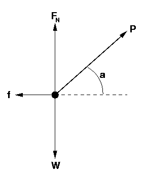

Force P (78.28 N) pulls on a crate of weight W (164 N) on a rough surface at a constant speed. The figure shows the directions of the forces that act on the crate. FN represents the normal force. The kinetic frictional force is f (51.25 N). The angle, a, is 49.1 degrees. Calculate the value of the normal force.
mg-Fsin(x)
I have attempted this problem by solving for the normal force. (16.73)(9.8)-51.25(sin)(49.1). I tried to work that out but it was incorrect because apparently the vertical force is zero. Could I get an explanation on what that means and where I should start?

Is it clar to you that ##\ mg\ ##, ##\ \ P\sin a\ \ ## and ## \ N \ ## are the only vertical forces in the story ?
And if ##N## would be zero, then ##\ mg = P\sin a\ \ ## would follow ?

The net vertical force here is zero. The normal force is one of the vertical forces. Others are weight and part of the pulling force.
Aha ! It says the NET vertical force is zero. There is no acceleration in the vertical direction. So you have ##mg## down, ##P\sin a## and ##N## both up. And the sum is zero.
The only difference with your working is that you used 51.25 instead of 78.28 N for ##P##.

Perhaps not being at scale, the posted diagram is confusing the OP.

Not being pulled in any direction, the block pushes the ground down with force W of magnitude 164 N and there is no kinetic frictional force f to talk about.

@Jujubee37: You do not need to find the mass. Simply replace 'mg' by '164' (Newtons).

Looks to me that you got confused between P and f when plugging numbers into your equation.

The answer I got was 104.79 N. I have practiced more problems similar to this one so I understand it now.

Yes I am aware now, my way got me the correct answer but yes plugging in 164 would be quicker.
