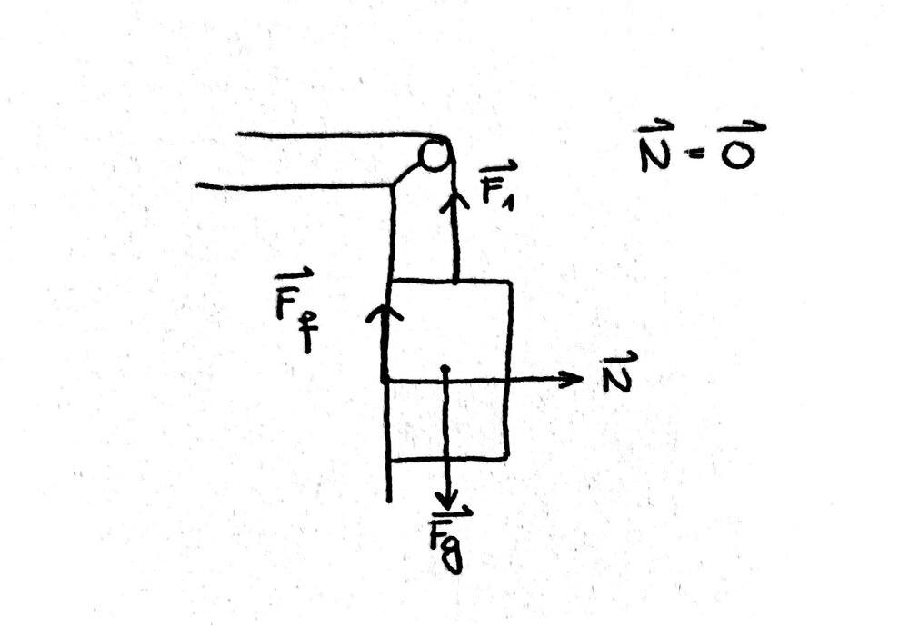

Does friction exist?
More in the solution
What I know is that the force of friction and the normal force are the components of a contact force. So force of friction is related to the contact force. Friction is also related to the normal force by equation ##F_t= μ\cdot N##.
In this case (because the block is not moving) N=0 and therefore ##F_t=0## and there is no friction.
What bothers me is the fact that the wall and the block are in contact so there must be a force acting on the block? Am I even thinking right? So what would be this force?
Also: Does anybody knows how did we get this equation ##F_t= μ\cdot N##?
I know that the experiments showed that on the horizontal surface the force of friction is proportional to the mass of the object we observe and the ##F_t= μ\cdot N## is true.
But how do we get the same conclusion in a vertical case like this?
In other words: were there experiments also in this case or we just took a concept and put it in a vertical direction?
If so - what happens if we side a block vertically between two walls and we have been given a static coefficient? Does the friction acts on the body or not?

At an atomic scale, there is a repulsion (and attraction) between the atoms of the wall and the block but this force gets canceled out. hence the Block remains in horizontal equilibrium. as long as the wall is not accelerated in the horizontal direction no normal reaction force will exist and hence there won't be any frictional force.

friction does not act on the body here as the Normal reaction with the two walls is zero. Hence the body accelerates down with ##g##.

Careful now! In the static case, the magnitude of the friction force is related to the magnitude of the normal force by the inequality ##F_s \leq \mu_s N##. Up to this threshold, the static friction force will just be whatever it needs to be to provide static equilibrium (zero net force). Only if the friction is limiting, i.e. the body is on the point of moving, will ##F_s = \mu_s N##.
On the other hand, dynamic friction is defined by ##F = \mu_d N##.
The origins of these equations are probably empirical, however theoretical justification (or at least models) can probably be found within a tribology textbook.

I'm not sure if this is the correct conclusion, as if the block is in contact with two walls, both walls can exert a contact force on the block (friction force + normal force).
Of course if the space between the walls is wide enough for the block to fall without touching the walls, there'll be no contact force on the block due to either of the walls!

If we consider friction force as the resistance to relative movement between two surfaces in contact, the principle of proportionality applies the same to horizontal, inclined or vertical surfaces.
Static μ is a proportionality coeficient between normal and resistive forces that is found experimentally for each couple of different materials.
The value is more or less equal to the tangent of the maximum angle of a slope over which a block is resting without sliding.
Your diagram shows an ideal situation in which the horizontal distances between pulley, rope point of attachment and center of mass of block respect to the vertical wall are exactly the same; therefore, there is no force pressing the block against the wall and vice-verse.
Basically, it is like the two surfaces were not in contact at all.
For any deviation of that ideal situation, you could have some perpendicular force between those two surfaces.
Hence, the block will not move vertically at all until the resultant vertical force becomes greater than certain percentage (static μ) of the magnitude of that perpendicular force (N).
After the relative movement is stablished, there will be a resistive force, of slightly smaller magnitude (dynamic μ * N) than the one previous to the movement.
