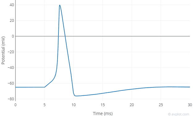

Just to recap on this thread:
  1. We want to create a frequency modulated audio output following a given curve for presentation to learners with a visual impairment.
  2. The given curve is generated by a system of (4) differential equations (ODEs) without an analytical solution.
  3. The Desmos website is capable of providing audio output, but it cannot solve differential equations.
One way of overcoming this is to find a (probably piecewise) approximation to the curve and input this into Desmos.
I think a better way is to create an application that can numerically solve ODEs, plot the results and produce an audio output. I have put something together to demonstrate this and it is available at https://avplot.com/#/hodgkin-huxley: an image of the graphical output is shown below. If this is useful, let me know and I will make it a bit smarter and add more functionality as time allows (e.g. the ability to enter arbitrary equations similar to Desmos, change the audio parameters etc). If it is not then it will probably die when the domain renewal comes up, although the (open) source will be available at https://github.com/avplot for as long as GitHub works.

I understand and appreciate any input. You suggested a couple of things in a previous post including (1) enabling users to enter arbitrary equations similar to Desmos, and (2) changing audio parameters...Both of these suggestions are great, though I would like to learn more. Which audio parameters could we actually adjust in this application?
Regarding this particular sonification: It could be useful to adjust the function such that the users can more easily identify specific features of an action potential. Specifically, it would be helpful to make the undershoot following the fall of the curve a bit more pronounced, e.g., by increasing its amplitude. It would be good to experiment with that particular feature of the curve. Currently, without any visual input, I would not be able to identify that there is an undershoot following the fall of the curve.
Parameters could be introduced to expand the freqency range for e.g. the lower part of the curve which would highlight the detail in this case.
