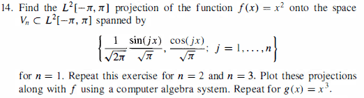

Textbook problem 14: find the L^2[-π, π] projection of f(x) = x^2 onto the space V_n spanned by 1/√(2π), sin(jx)/√π, cos(jx)/√π for j = 1 to n, then repeat for n = 2 and n = 3 and for g(x) = x^3.

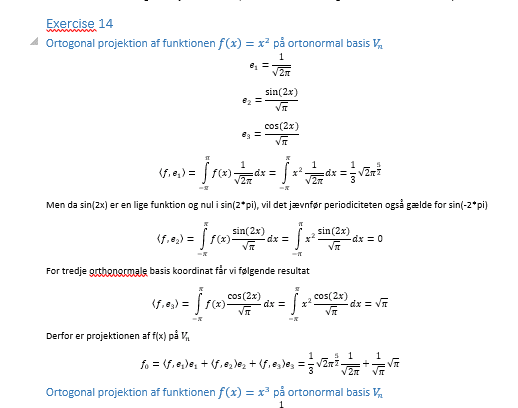

Hi Ray. Yes and I've developed my solution much more. It's still not quite correct though.
Will someone help me?
Handwritten-style worked solution in Danish: orthogonal projection of f(x) = x^2 onto orthonormal basis V_n, using e1 = 1/sqrt(2pi), e2 = sin(2x)/sqrt(pi), e3 = cos(2x)/sqrt(pi) and integrals over -pi to pi giving the projection f0 = (1/3)sqrt(2pi^3)e1 + (1/sqrt(2pi))... with inner products computed.
