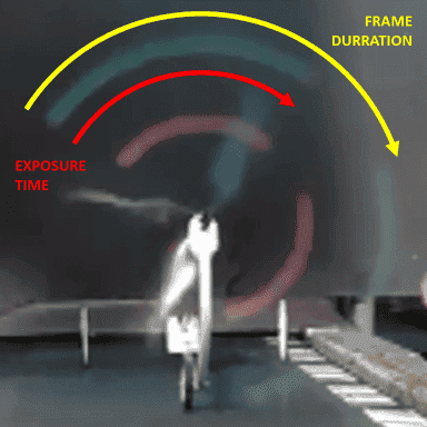

Here is what a fast spinning propeller can look like in two consecutive frames of a video overlaid. Note that the smeared green & red markings are on one blade only, so the two green arcs represent the same object, in two consecutive frames:
As you see the exposure time (time captured in each picture) is not the full frame duration (1/30s), but only about 75% of it. This fraction can vary, depending on what the camera chooses based on available light or your manual settings.

I see thanks for the pictures for clearification! (Im visual person) and i think my gopro doesn't use any kind of flashes etc.
