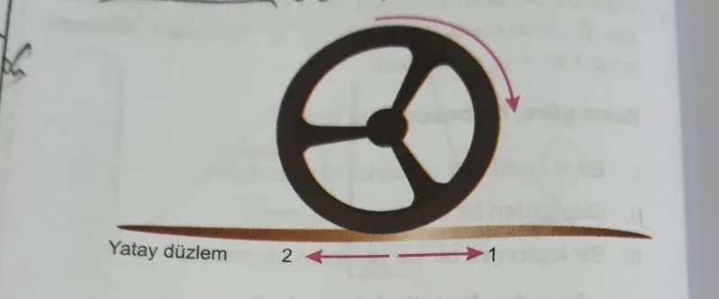

TL;DR Summary: I have a question about the friction on a wheel and how it works.
Since the question was in another language i will try to translate.
This wheel was spinned the way shown in the photo while it was still in air. Then the wheel was put on the ground. And it rolled without sliding without accelarating.
Regarding questions whether if they are true or false:
I- When put on ground, friction was applied in direction 1.
II- When put on ground, friction in the direction 2 is the force which rolled the wheel (to the right).
III- While rolling without accelarating (constant speed), the wheel is in equilibrium state.
Which of them are correct?
Are you sure you translated this part correctly? The wheel cannot go from spinning in the air to rolling on the ground instantaneously without some sliding and acceleration during the initial contact phase with the ground.
I guess you gotta ignore them since they are so small in numbers. (At least thats what we do here while solving questions)
Sorry, the question makes no sense as asked. At least not to me. Perhaps other users will be able to decode what the question is really asking.
