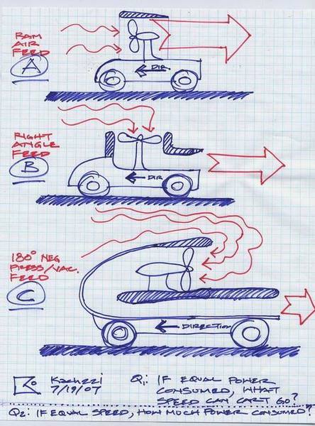

Good question, I assume that if the propeller is standing mounted on your desk that more power is consumed (for equal amount of thrust) to feed or draw in the air.
Perhaps there is a "ram air" factor which must be added, or a feed air equation which must be subtracted.
If you get your question answered, maybe I can get a related answer for A, B & C.
