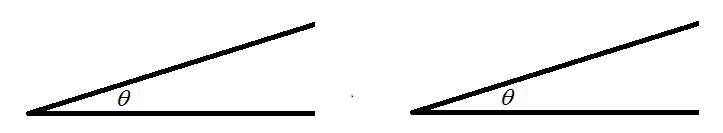

girts said:
I did not really get the wedge analogy , couldn't "picture it" in my mind.
This figure shows two wedges.
The upper surface of each wedge forms an angle ##\theta## with the horizontal. Another way of describing the tilt of that upper surface is with the slope. Imagine increasing the value of the angle ##\theta## so that the upper surface becomes more steep. When ##\theta## is zero the slope is zero, but as the angle increases so does the slope. As ##\theta## approaches 90° the upper surface approaches vertical and the slope increases beyond all bounds. The slope is given by ##\tan \theta##.

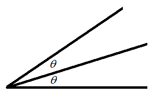

This next figure shows those two wedges stacked, one on top of the other.
Now the upper surface forms an angle ##2\theta## with the horizontal, but the slope is not ##2 \tan \theta##.
I suck at trig, but in summary then, the slope should be ##tan{\ 2 \theta}## , right?
And when ## \theta → 0 ## , ##tan{\ 2 \theta} → 2 \theta## , but when ## \theta ## gets larger, the two diverge from one another?
