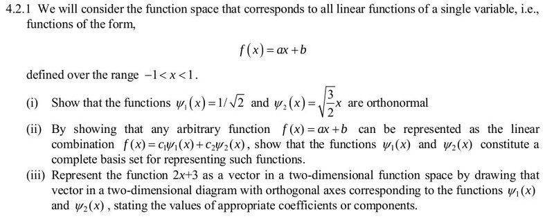

In attachment "question.jpeg"
i. I can do
ii. I need some help
iii. I need some help
i. \int_{-1}^{1} \Psi_{1} \Psi_{2} dx = 0
ii. ?
iii. ?

Try writing b explicitly in terms of one of the coefficients, c1 or c2, and a in terms of the other.
