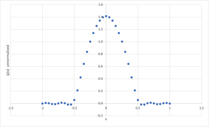

That's not obvious to me. Using this integral, I found the first eight non-zero coefficients and plotted the summation to get the graph shown below (##L=1##). It does what it's supposed to do, no?
I believe this is correct, however my issue is that the question specifically asks for the probability of the second state, which would be the second coefficient squared. Perhaps I have it wrong, but if you omit the even coefficients in that graph I think the same graph should be produced. Thank you for graphing them though, I didn't think to do that.

It cannot be otherwise by symmetry. One is integrating an odd function, ## \cos{\frac{\pi x}{L}} \frac{1}{\sqrt{L}} \sin{\frac{2 \pi x}{2L}}## over symmetric limits which means that the integral vanishes. All the ##c_n## terms with ##n=~##even must vanish for the same reason. That is as it ought to be because you are expanding an even function and you cannot have odd terms in the expansion.
The energy level diagram consists of all the odd ##n## coefficients. The first excited state has ##n=3##, the second excited state ##n=5## and so on.
