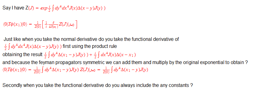

Can someone please explain how you take a functional derivative of a generating function. I have included a basic example of how I understand it, if it's not the case can someone explain explicitly for a dummy how this is performed. My question is in picture form, as it's much easier for me to do it this way.
Many thanks
Hi
In the last sentence I mean you do include constant terms like I have done when taking the product above?
Replace ##J## by ##J+\epsilon dJ##, expand, drop terms involving higher powers of ##\epsilon##. The coefficient of ##\epsilon## is the integral of the functional derivative ##dZ(J)/dJ(x)## multiplied by ##dJ(x)##.
