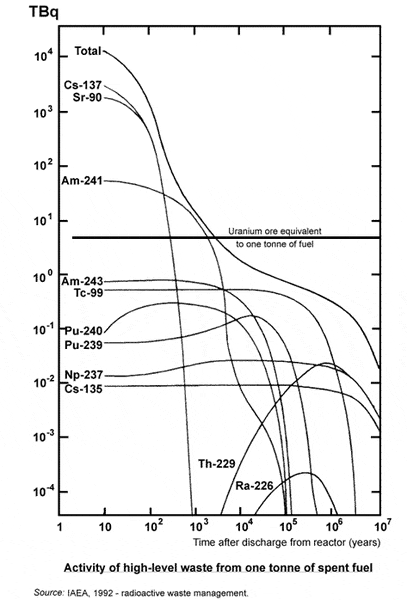

Not directly but It will make lots of neutrons which will activate the containment vessel. ITER is suppose to obtain data on this issue. ITER is a breeder for tritium so it is not just a simple "Sun in a bottle". How long will the bottle last? Sure I say go for it but don't put all your energy concerns "eggs" in one basket for now. I am doubtful I will see ITER go on line in my lifetime and I am doubtful that most of you will see a viable commercial reactor in yours.
  • #44
The vessel will become activated. It is studied how that effect can be mitigated. Medium lifetimes are the most problematic. Anything living shorter than about a year (half-life) can be stored until it is decayed, everything living billions of years has a tiny activity and no relevant heat production, and can be stored underground forever.
Fusion power plants won't work completely without problematic waste, but they do not produce all the problematic (trans)actinides fission power plants generate and the amount will be significantly smaller.

...but they do not produce all the problematic (trans)actinides fission power plants generate and the amount will be significantly smaller.
Not necessarily so for all fission, but for thermal spectrum U235 fission which happens to be the dominate form of fission reactor at the moment. It need not be so. The Russians are currently operation two fast reactors that burn actinides, and the U.S. has a couple startups with low volume waste designs.

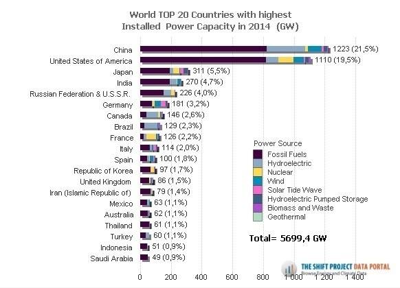

Something must be working. How do you think over 1100 Gigawatts of energy are getting transported?
image compliments of http://www.tsp-data-portal.org
