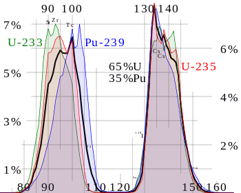

Stephanus said:
Since the fision reaction is: Neutron + U235 -> Kr92 + Ba141
That's not correct. That is one channel through which 235U will fission. In reality, fission produces a range of possible fission products. For 235U, the mass distribution looks like the red curve:
(Credit: Wikimedia)
For isotopes such as 234U, 237Np, 238Pu, 241Am, it's important to know that while 235U will fission in a neutron induced reaction quite a lot of the time, this isn't the only reaction that will occur. For example, 237Np is formed by successive neutron capture from 235U +2n -> 237U, which beta decays into 237Np. In addition, 237Np will form in spent fuel from 241Am, or from neutron knockout reactions from 238U or Pu. In turn, 241Am is formed. Neutron capture followed by decay is the explanation for the rest of the actinides you are asking about.
The neutrons resulting from fission be moderated, thermalised, and will either hit another uranium, inducing another reaction, or will be otherwise absorbed. The key part of the running of a nuclear reactor is keeping the neutron flux to what you want it to be - too low, the reactor will stop, too high, the reactor will run away. The control rods control the neutron flux, yes.
