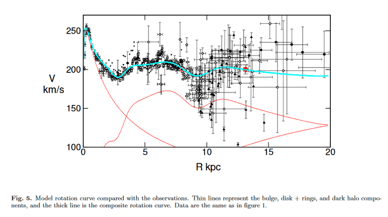

But then you need to figure out how to build a density model, so as to match the curve. This is done separately for bulge, disc, and halo. So when you see a graph such as this one:
(source: https://arxiv.org/pdf/0811.0859.pdf)
The component curves that you're trying to match to the observed one are derived from whatever density model you might have chosen for that component. This is what I meant.
(in that paper they show their density model in Fig.2)
Bandersnatch said:
No, I don't mean the observed velocity curve - you're right, velocities and distances are the only direct observables.
But you should not need any density model to derive the density from observed rotation curve!
The exercise should be simply:
1) For every r, v2*r should be proportional to the total mass enclosed by r
2) Differentiating the observed v2*r with respect to r gives the mass of each shell from r to r+dr
3) Divide it by volume (4πr2*dr) gives the density
Probably the nonspherical shape of disc galaxies introduces some complications, though...
