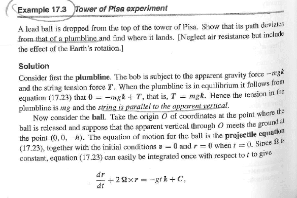

A ball is dropped from the top of the tower of Pisa (which of course is not vertical). Neglect air resistance and take into account Earth's rotation for a) and b).

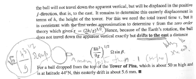

a) Show that its path deviates from that of a plumbline and that the ball is drifted to the east a distance (##d_p## stands for traveled distance from the tower of Pisa):
$$d_p = \sqrt{\frac{8 h^3}{9g}}\Big(\Omega \sin \beta \Big)$$

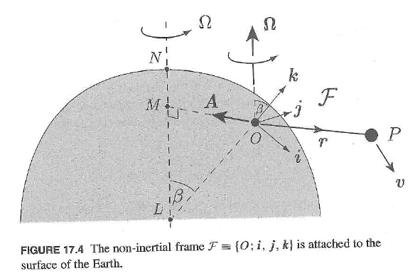

Earth's angular velocity (please see attached image if you want to know why):
$$\mathbf \Omega = -(\Omega \sin \beta \mathbf) \mathbf i + (\Omega \cos \beta) \mathbf k$$

a) Let's first analyse the plumbline.
When it is in equilibrium, it follows from the projectile equation on a rotating Earth that:
$$\mathbf 0 = -mg \mathbf k + \mathbf T$$
Thus, the tension in the plumbline is ##mg## and the string is parallel to the apparent vertical.
Let's now analyse the ball. Suppose that the apparent vertical through ##O## meets the ground at the point ##(0, 0, -h)##. Let us have the following initial conditions: ##\mathbf v = \mathbf 0## and ##\mathbf r = \mathbf 0## when ##t = 0##. As ##\mathbf \Omega## is constant, we can integrate projectile equation on a rotating Earth with respect to time to get:
$$\frac{d \mathbf r}{dt} +2 \mathbf \Omega \times \mathbf r = -gt \mathbf k + \mathbf C$$
Applying initial conditions we get:
$$\frac{d \mathbf r}{dt} +2 \mathbf \Omega \times \mathbf r = -gt \mathbf k$$

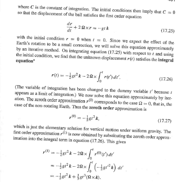

$$\mathbf r (t) = - \frac 1 2 g t^2 \mathbf k - 2 \mathbf \Omega \times \int_{0}^{t} \mathbf r(t') dt' \ \ \ \ (1)$$
Let's get a solution for the above equation by using the mathematical method called iteration.
The zeroth order approximation corresponds to the non-rotating Earth case. Thus:
$$\mathbf r_0 (t) = - \frac 1 2 g t^2 \mathbf k$$
In order to get the first order approximation we just have to plug the zeroth one into ##(1)## and integrate to get:
$$\mathbf r_1 (t) = - \frac 1 2 g t^2 \mathbf k - 2 \mathbf \Omega \times \int_{0}^{t} \mathbf r_0 (t') dt'$$
$$\mathbf r_1 (t) = - \frac 1 2 g t^2 \mathbf k + \frac 1 3 g t^3 (\mathbf \Omega \times \mathbf k)$$

The interesting thing is that the first order approximation predicts that the ball will drift to the +ive ##\mathbf j## direction. Is this direction east? (based on the provided diagram). My book states so but I do not see it...
Now we get the ##\mathbf j## component of the distance. What we could do is solving the time for the zeroth approximation, ##t= \sqrt{2h/g}##, and then plug it into the first approximation. This should be OK, as both approximations are small. We get:$$\frac 1 3 g \Big(\frac{2h}{g}\Big)^{3/2} (\Omega \sin \beta) = \sqrt{\frac{8 h^3}{9g}} (\Omega \sin \beta)$$
That's nice! The only thing I am missing is understanding why my book states it drifts to the east.

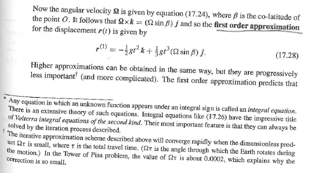

I don't see how you got this$$\mathbf r_1 (t) = - \frac 1 2 g t^2 \mathbf k + \frac 1 3 g t^3 (\mathbf \Omega \times \mathbf k)~~~~~~(1)$$from this$$m\Big( \frac{d \mathbf v}{dt} + 2 \mathbf \Omega \times \mathbf v \Big) = -mg \mathbf k~~~~~~(2)$$Equation (2) provides three coupled equations,$$\ddot{x}=2 \Omega \left(\dot{y} \cos (\beta )-\dot{z} \sin (\beta )\right)$$ $$\ddot{y}=-2 \Omega \dot{x} \cos (\beta )$$ $$\ddot{z}=2\Omega \dot{x} \sin (\beta )-g$$How did you get from these three to your equation (1)? Normally, one starts from the zeroth order equations (##\Omega \approx 0##) ##x(t)=x_0+v_{x0}t##; ##y(t)=x_0+v_{y0}t##; ##z(t)=v_{z0}t-\frac{1}{2}gt^2##. Then one would substitute these in the three acceleration equations and integrate twice to get the first order equations for ##\vec r(t)##. Did you do that?
I took your ##(2)## and integrated twice with respect to time (with the given initial conditions ##v=0## and ##r=0## when ##t=0##) to get:
$$\mathbf r (t) = - \frac 1 2 g t^2 \mathbf k - 2 \mathbf \Omega \times \int_{0}^{t} \mathbf r(t') dt'$$
And then I applied iteration up to first order.
Section a) is solved in Gregory's, which I have exactly typed.
However, for sake of clarity, I will also upload pictures of the solution.

Let's now have a closer look at the figure 17.4 I attached at #1 (which happens to show the above-equator case). Note that the unit vector ##\mathbf{i}## points South, the unit vector ##\mathbf{j}## points East and the unit vector ##\mathbf{k}## points radially outwards. OK. By trigonometry we see that the formula for ##\mathbf{\Omega}## in the ##Oxy## plane is
$$\mathbf{\Omega} = -\Omega \sin \beta \mathbf{i} + \Omega \cos \beta \mathbf{k}$$

At what angle one gets the east drift (for instance) ##d=\frac{2\Omega}{3} \sqrt{h^3}##?
Mmm but this is too simple... So I may be the one wrong. What do you all think? 🤔
b) A ball is now dropped from a vertical tower

Fwiw, here's a nonvectorial way:
We can think of the ball as having been thrown eastward at ##h\Omega \sin(\beta)##. For simplicity I'll leave out the trig from hereon.
After time t, it has traversed an arc ##t\Omega## relative to the Earth's centre, so it is as though the angle of gravity has changed by that much. That doesn't alter the component parallel to the original vertical much (second degree), but it adds a component opposing the original velocity of ##-gt\Omega##. That velocity is thus reduced to ##(h-\frac 12gt^2)\Omega##, and the distance covered is ##(ht-\frac 16gt^3)\Omega##.
Substituting ##t=\sqrt{\frac{2h}g}## yields the ##\Omega\sqrt{\frac{8h^3}{9g}}## result.

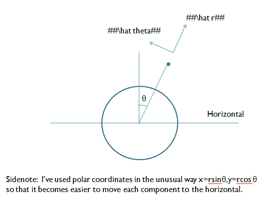

Actually, I think it's worth considering the same problem but from a non-inertial (rotating) frame.
We expect to get a larger distance, as the gravity dragging the particle in the horizontal direction is now weaker due to the centrifugal acceleration.
Let's check what the acceleration of the particle is (using polar coordinates; argh let's not drop trigonometry factors for now)
$$\mathbf{g_{\text{eff}}} := -g \mathbf{\hat r} - \mathbf{\Omega}\times(\mathbf{\Omega} \times \mathbf{r})=(-g+(R+h)\Omega^2 \sin^2(\theta))\mathbf{\hat r}-(R+h)\Omega^2\cos(\theta)\sin(\theta)\mathbf{\hat \theta} $$
We now move to the horizontal (by recalling what's the connection Polar-Cartesian: ##\hat r=(\sin (\theta), \cos(\theta)), \hat \theta=(\cos (\theta),-\sin (\theta))##. Thus we have
$$g_{\text{eff}}=-g\sin(\theta)+(R+h)\Omega^2\sin^3(\theta)-(R+h)\Omega^2\cos^2(\theta)\sin(\theta)=-g\sin(\theta)-(R+h)\Omega^2 \sin(\theta)\cos(2\theta)$$
Where I've used ##\cos^2 \theta - \sin^2 \theta =\cos(2\theta)##
Thus the velocity of the particle in the horizontal direction is
$$v(t)=(R+h)\Omega\sin(\theta)-\frac 1 2 g t^2 \Omega \sin(\theta)-(R+h)\Omega \sin(\theta)\cos(2\theta)$$ $$=2(R+h)\Omega\sin^3(\theta)-\frac 1 2 gt^2\Omega\sin(\theta)$$
Where I've used ##1- \cos(2\theta)=2 \sin^2 (\theta)##
Thus the distance is
$$x(t)=2(R+h)\sin^3(\theta)\Omega t -\frac 1 6 gt^3\Omega\sin(\theta)$$
Dropping trig factors we of course get
$$x(t)=2(R+h)\Omega t -\frac 1 6 gt^3\Omega$$
Which is indeed greater than the distance obtained in the inertial frame.
For the sake of completeness, let's get ##d##. Subtracting the distance covered by the base of the tower ##2R\Omega t## we get ##5\Omega\sqrt{\frac{2h^3}{9g}}##
