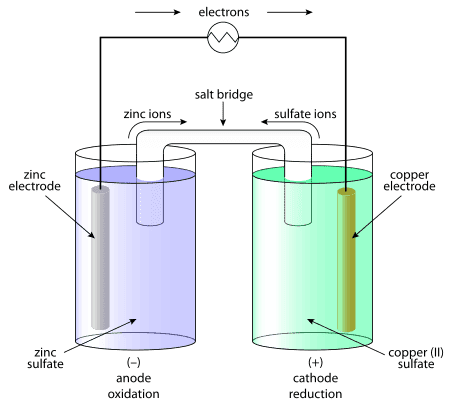

cianfa72 said:
no external conductive path across electrodes
I interpreted this as: yes salt bridge, no bulb (picture wikipedia):
242420
correct

cianfa72 said:
What happens when salt bridge is inserted between half-cells without any external electric connection as before ?
Good question ! @Borek ?
My estimate is that some ions will move but that stops almost immediately once the charge balance is restored

cianfa72 said:
What happens when salt bridge is inserted between half-cells without any external electric connection as before?
There will be some shift of the charges - positive charges will be attracted to the negative electrode till they neutralize it (screen the electric field between the charged electrodes).
Again, this is hardly chemistry, this is just how charges behave.
Just to be sure I got the point: positive charges you're referring to are basically the cations (positive ions) belonging to the salt bridge that will shift towards the negative electrode (Zn(s)) neutralizing some electrons on it (analogus process about anions that will shift from salt bridge towards anode) ? In that case the electric field between the charged electrodes will suffer a small decrease as the net emf of the cell itself ?
You have ions (cations, anions) everywhere, not only in the salt bridge. Ions neutralizing the electric field will be just on the electrode surface (google double layer) and there will be no net electric field in the solution.
