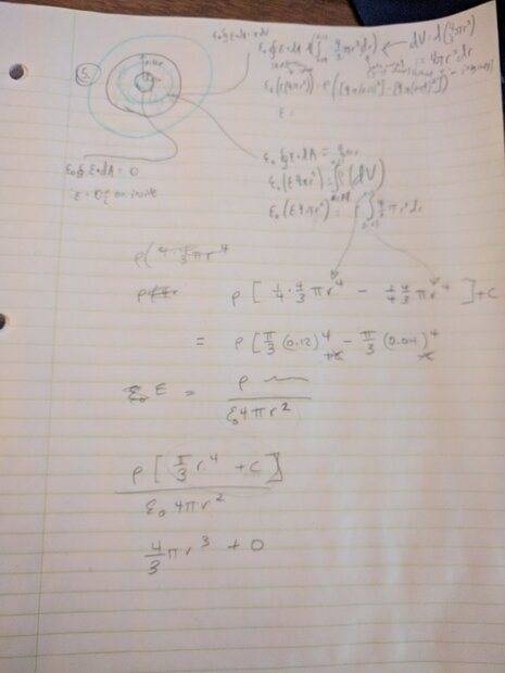

I tried integrating for 4/3 pi r^3 with r= 0.04 to r=0.12, and I found that the charge decayed exponentially from r=0.04 (1/r^2), but I know that is incorrect, because for volume charge densities, it should increase from r=0.04...

Handwritten derivation on lined notebook paper of the electric field E(r) inside a uniformly charged sphere with a spherical cavity, using Gauss's law with a Gaussian sphere, a small sphere sketch, and a bottom line reading E(r) = (rho/epsilon_0)(4/3 pi r^3 - 4/3 pi R_i^3) divided by 4 pi r^2 with labels 'big sphere' and 'little sphere'.
Is this correct?
I can’t make everything out but from the last line it doesn’t look to be.
We have constant density ##\rho## correct? Charge is volume times density…correct?
Now to find total charge we have to find the volume. If you’re dead set on integrating on the right hand side you would integrate the surface area (times ##dr##) to find volume. You don’t integrate volume to find volume. Volume is the integral of surface area.
Compute ##\rho \int_{R_1}^{r} 4 \pi r^2 \, dr##.
Set that equal to ##E (4 \pi r^2 )## and solve for ##E##

Thank you soooo much! I think I understand now. I have ##\rho(4/3 \pi r^3 - 4/3 \pi R_1^3)##
