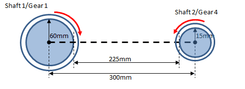

Ok so I have answered parts a to c.
2a)
The design states that the shafts must rotate in opposite directions, this means that there must be an even number of gears. If I use 2 gears they will rotate in opposite directions but each gear will have to be large in diameter to maintain the stipulated distance between centers of 300mm. As the design requires the maximum gear diameter to be kept to a minimum the amount of gears used will have to be increased in order to reduce their individual diameters. The design criteria also stipulates that the maximum amount of gears that can be used is 4. This leaves using 4 gears as the only option to fulfill both of these design criteria.
Shaft 1 rotates at 100 revs min-1 and shaft 2 rotates at 400 revs min-1 which gives a ratio of 400:100 or G = 4:1. Therefore shaft 2 must be 4 times smaller than shaft 1 to achieve the desired rotational speeds.
To calculate the smallest diameter any gear can be when the minimum number of teeth is 15 and the module is set at 2mm the following equation can be used:-
m = D / N m = 2mm
D = mN N =15
D = 2 x 15
D = 30mm
Shaft 1/Gear 1
Shaft 2 is 4 times smaller than shaft 1 so this would make shaft 1 4 x 30 = 120mm. With shaft / gear 1 at 120mm diameter and shaft 2 / gear 4 at 30mm diameter this leaves the gap in between 225mm to be filled by gears 2 and 3.
As 225mm is to be split between 2 gears each of which are required by design to have at least 15 teeth with the number of teeth a multiple of 5 and a module of 2 it is not possible to meet these requirements with the remaining gap of 225mm whilst keeping the gear centers in a straight line. Although all the design criteria can be met with the above configuration the gears would have to be moved of center in order to keep the distance between the shafts at 300mm. I have opted to keep all the gear centers in line by increasing gear 4 (shaft 2) to 40mm. Due to the ratio established earlier of 4:1 this will increase the diameter of gear1 (shaft 1) to 160mm leaving a gap of 200mm to be filled by gears 2 and 3.

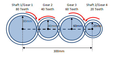

To calculate the number of teeth for each gear the following equation will be used:-
m = D / N
N = D / m
Gear 1 (Shaft 1)
N = 160 / 2 m = 2
N = 80 teeth D = 160mm
Gear 2
N = 80 / 2 m = 2
N = 40 teeth D = 80mm
Gear 3
N = 120 / 2 m = 2
N = 60 teeth D = 120mm
Gear 4 (Shaft 2)
N = 40 / 2 m = 2
N = 20 teeth D = 40mm
To establish the order of the 2 idler gears the revs min need to be calculated for each gear. They are given for gear 1 (shaft 1) as 100 revs min-1 and gear 4 (shaft 2) must be 400 revs min-1 as set by the design criteria. The following calculations show that gear 2 must be 80mm diameter and gear 3 120mm in order to achieve 400 revs min-1 at gear 4 (shaft 2).Gear 2
Gear 2 / Gear 1 = 40 / 80 = 1 / 2 = 1:2
100 x 2 = 200 revs min-1
Gear 3
Gear 3 / Gear 2 = 60 / 40 = 1.5 / 1 = 1.5:1
200 / 1.5 = 133.333 revs min-1
Gear 4
Gear 4 / Gear 3 = 20 / 60 = 1 / 3 = 1:3
133.333 x 3 = 400 revs min-1
The idler gear ratio is not important. No matter what size an idler gear is, the same number of teeth will pass on each side per minute. The only requirement is to fill the 200 mm gap with 100 teeth. So why do you select idlers of 40 and 60 teeth?
Is efficiency improved by using two 50 tooth gears, with diameters of 100mm each, because of the 5 Nm loss per idler shaft?
What about 15 and 85 tooth idlers? or 85 and 15? What about the orderly series of 80 to 60 then 40 to 20.
Honestly I used 60 and 40 as it was the first combination I tried through trial and error. I can see now that as long as the input spins at 100 revs min with a ratio of 1:4 then the final gear will always be 400 revs min-1.
