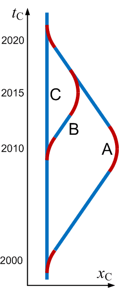

I often notice the differential aging of the twins being attributed to the acceleration. While the acceleration is necessary, thinking of it as the cause of the differential aging doesn't hold up: it leads to self-contradiction.
Some time ago I came across the following diagram that was uploaded in 2008:
https://www.physicsforums.com/attachment.php?attachmentid=14191&d=1212060478
This is from the thread https://www.physicsforums.com/showpost.php?p=1747855&postcount=4"
It's a triplet this time. C stays at home, A and B go on a journey. In the worldlines the red sections represent a phase of acceleration. A and B both experience the same acceleration for the same time, but A's total elapsed time is shorter than B's.
Cleonis said:
What is common to all diagrams is that the traveler covers more spatial distance than the stay-at-home twin.
Look at your diagrams. This is only true in the first diagram. In the 2nd and 3rd the spatial distance traveled by the two twins is equal.
Yeah.
I was completely focused on the aspect that in all diagrams the stay-at-home worldline is a continuous straight line, whereas the traveler's worldline always consists of multiple sections that are at an angle to each other.
Ah well.
That is indeed a correct observation. One twin's worldline forms two sides of a triangle and the other twin's worldline is a single side of the triangle. This observation analogous to the triangle inequality.
In Euclidean geometry the sum of the lengths of two sides of a triangle is always longer than the length of the third side. In Minkowski geometry the sum of the time of two sides of a timelike triangle is always shorter than the time of the third side.
