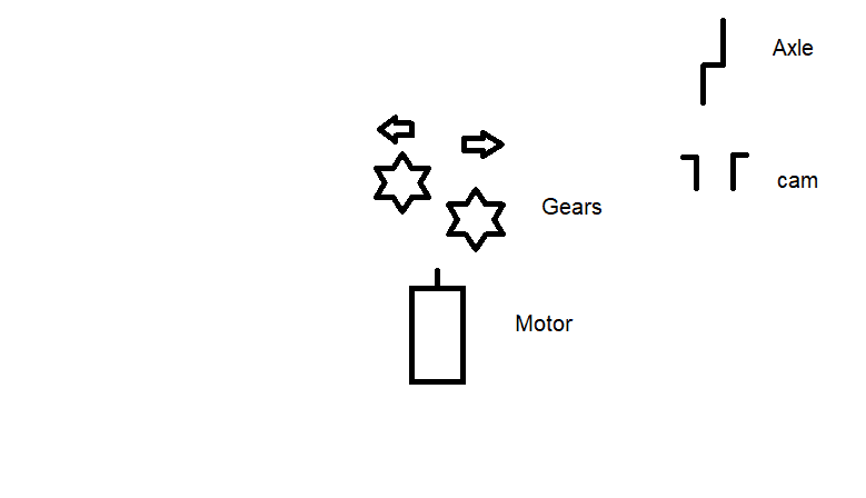

Goal: To have an axle rotate back and forth from one position to the other.
We have a motor rotating in one direction
How so solve this in a smart/simple way?
I'm thinking having
1. one cog on the motor axle, rotating the same way as the motor
2. a second cog connected to the above cog that would then rotate in the other direction.
3. having one "camshaft" each, roughly L-shaped part, connected to each cog. The cams will then rotate in different direction.
4. The axle that should rotate back and forth is roughly Z-shaped with an "offset" part that will be touched by the cams.
5. This will generate a movement back and forth when the cams, revolving in different direction touches the offset part of the axle.
See my extremely silly drawing attached =)
*will this work in principle?
*is there a better/simpler way to do it?
Would there for instance be a cleverly designed cam shape that can singlehandedly do the same job if just put on the motor axle?
  • Rough hand-drawn sketch of a mechanism: a motor with a shaft, two six-pointed star gears with arrows showing opposite rotation, and two L-shaped cam pieces beside an offset Z-shaped axle, labelled Axle, cam, Gears and Motor.

No it has nothing to do with wheels. There's no purpose.
The axle rotates like 90 degrees in one direction, and then it should rotate 90 degrees back to where it began. Thats the "requirement".
Problem is that the motor only rotates in one direction, otherwise you could just drive the engine in one direction and then put it in reverse and drive it back. Therefore you need some kind of mechanism in betweeen
If you only want 90° then a crank on the motor, linked to a longer crank on the shaft will do that.
If you want more than 90°, maybe several turns, then mount a crank or an eccentric on the motor shaft, that pushes and pulls a Pitman arm.
A gear rack on the Pitman arm, is engaged to a pinion gear on the rotating shaft.
The throw of the motor crank, and the size of the pinion, sets the angle of shaft rotation.

ok so somewhat like pistons in an engine: first "piston" goes up, and the other piston down, and pushes the axle one way. Then the second piston goes up and the first down, pushing it the other way?
The axle would have like a U-shaped horsewhoe at the end.
Not necessarily. The motor could have a simple crank, or an eccentric.
https://en.wikipedia.org/wiki/Eccentric_(mechanism)
Since shaft rotation is not beyond about 120°, the connecting link does not need to cut the shaft axis. A radius arm clamped to the straight shaft, would be driven by one end of the link.
Just Google washing machine transmission. No need to reinvent the wheel.
