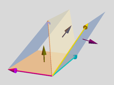

If the cross product in ℝ3 is defined as the area of the parallelogram determined by the constituent vectors joined at the tail, how does one go about proving this product to distribute over vector addition?
I've attached a drawing showing cyan x yellow, cyan x magenta, and cyan x (magenta + yellow). If the parallelogram cyan x yellow is parallel transported along the magenta vector, an open-ended prism is formed, with the these cross products as faces.
If the open ends are capped by congruent triangles and the vector sum of all faces, treated as surface elements with outward-facing normals is taken, the result is the null vector. Since the end-caps cancel, this tells me the sum of any two of the remaining faces is equal to the other.
I believe this result, somehow demonstrates the proposition, but I don't know if it would persuade an independent observer.
My biggest concern is that the general proof that the sum of outward facing surface elements is the null vector relies on the distributive property of the cross product.

I suspect Joos intended a proof similar to his 2D demonstration of the distributive property of the scalar product over vector addition. I don't believe he actually provides a formal generalization of that proof to 3 dimensions. Nonetheless, it is conceptually easy to grasp. https://books.google.com/books?id=btrCAgAAQBAJ&lpg=PP1&pg=PA12#v=onepage&q&f=false
This is why I attempted to appeal to the diagram in the head message of this thread. It communicates in terms of the geometric spirit of the definition of the vector product as a directed plane area. If I'm following Joos correctly, he places the proof of the distribution of vector multiplication over vector addition prior to its resolution into components, which, in his development, relies upon that distributive property. Unfortunately, my vague argument seems to rely on the results presented in fig. 8 and related text. https://books.google.com/books?id=btrCAgAAQBAJ&lpg=PP1&pg=PA12#v=onepage&q&f=false

I was a bit hasty last time, there is an elementary proof of distributive property for the cross product, one you can present to high school students.
Namely, we first note that the cross product ##\mathbf u\times \mathbf v## does not change if we replace ##\mathbf v## by its projection ##\widetilde{\mathbf v}## onto the orthogonal complement ##\mathbf u^\perp## of ##\mathbf u##. You can see that because ##\widetilde{\mathbf v}## belongs to the plane spanned by ##\mathbf u## and ##\mathbf v##, the areas of parallelograms defined by ##\mathbf u ##, ##\mathbf v## and ##\mathbf u ##, ##\widetilde{\mathbf v}## coincide, and the direction of the shortest rotation from ##\mathbf u ## to ##\mathbf v## is the same as he direction of the shortest rotation from ##\mathbf u ## to ##\widetilde{\mathbf v}##.
So ##\mathbf u\times \mathbf v= \mathbf u\times \widetilde{\mathbf v}##. Second, the projection onto ##\mathbf u^\perp## (in fact any projection) is a linear transformation, so ##\widetilde{\mathbf v_1+\mathbf v_2} = \widetilde{\mathbf v}_1 + \widetilde{\mathbf v}_2##.
So, to prove the distributive property we need to show that $$\mathbf u\times (\widetilde{\mathbf v}_1 + \widetilde{\mathbf v}_2) = \mathbf u\times \widetilde{\mathbf v}_1 + \mathbf u\times \widetilde{\mathbf v}_2. \tag{1}$$ But what is the cross product ## \mathbf u\times \widetilde{\mathbf v}##? We can see from the definition of the cross product, that it is obtained by rotating the vector ##\widetilde{\mathbf v}## in the plane ##\mathbf u^\perp## by ##90^\circ## (clockwise if we are looking at this plane in the direction of the vector ##\mathbf u##) and then multiplying it by the length of ##\mathbf u##. Rotation and multiplication by a scalar are linear transformations, so (1) should be obvious.
