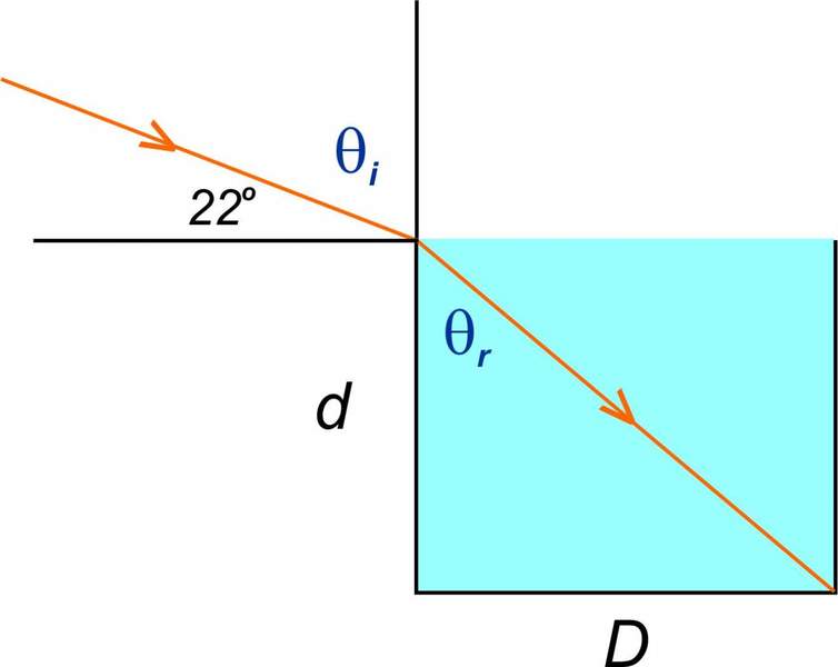

1. A cylindrical tank 2.4 m deep is full to the brim with water. Sunlight first hits part of the tahnk bottom when the rising maes at 22o angle with the horizon. Find the tank's diameter

1. I can't imagine the situation and I don't understand this part :"Sunlight first hits part of the tank bottom when the rising makes at 22o angle with the horizon."

Sunlight refracted to just reach the bottom of the tank.
  • Ray diagram of a light ray entering a shaded rectangular block from air at an angle of 22 degrees to the surface, refracting toward the normal, labelled incidence angle theta i, refraction angle theta r, depth d and width D.
Oh it is actually pretty easy. Just use the snell's law to find the angle of refraction and use tan to find the diameter.
