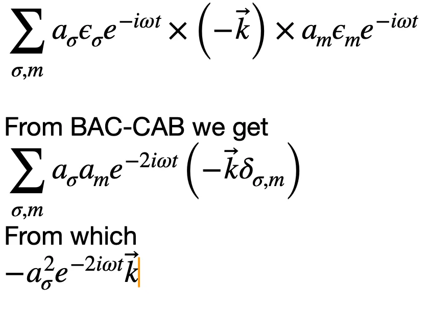

Hi @Matterwave
I am not making any real headway, would you mind taking a look please? I attached the part I am working with now after using the delta function. I have tried to use the fact that the ##\vec{A}(\vec{k},t)^*= \vec{A}(\vec{-k},t)## and see that since I am doing integrals over positive and negative values of k I could get rid of some terms, but I am not sure how to do it properly. Can you please help?
Thank you!

I see you have a single sum over ##\sigma##. You might consider that a bit more. How did you get a single sum?
Ah, sorry, in my actual I made it a double sum not to prejudice the fact that the electric and magnetic field would be at same polarization all the time. So I actually had it as a sum of ##\sigma## and a variable ##m##. Sorry I didn't write that
Ok, then write out what you actually get. One full term that has two ##a## in it for example. Then do BAC-CAB. After that you should have a term that you can make some symmetry arguments about.

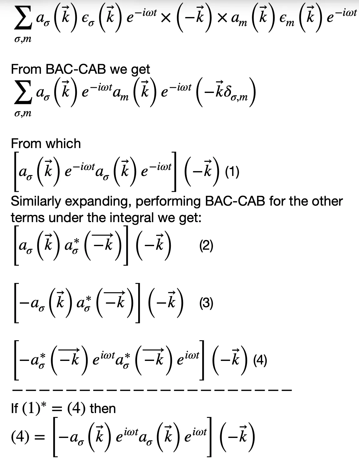

Right, and this is where I had gotten confused. I think I am not seeing what the symmetry argument should be, for instance, let us say I distribute the first a term, we'd get something like this: Attached and I would get another one like that with the complex conjugate

Be careful suppressing the ##\vec{k}## arguments (inside ##a## and ##\epsilon##). They are important here.
Ok. It is probably starring at me or I am doing something wrong, but unfortunately, I am not seeing what else I can do. Attached you will see when I expand all four terms and do the triple product etc. The first and fourth results are almost complex conjugates of one another except for not being evaluated at the same ##\vec{k}##, but since I am integrating over all possible values of ##k## and if I, in addition, use the property that ##A\left(\vec{k},t\right)^*=A\left(\vec{-k},t\right)## I might get them to cancel (since they are of opposite sign), not sure if that is doable. Then for terms (2) and (3) I might be getting a sign error because they cancel...What do you think?

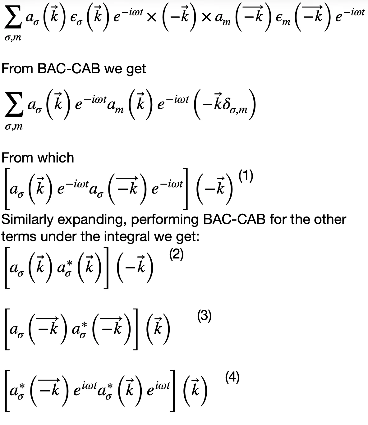

Two things:
1. You need to be more careful with your algebra. The fourier integral is going to get you a ##\delta^3(\vec{k}+\vec{q})## so actually you should have something like (I'm gonna drop a bunch of scalars) ##a_\sigma(\vec{k})\vec{\epsilon}_\sigma(\vec{k})\times [(-\vec{k})\times a_m(-\vec{k})\vec{\epsilon}_m(-\vec{k})]##. So you gotta do better book keeping. For a calculation like this, even a small error (missed minus sign) changes the argument significantly.
2. Eventually what you'll get out of a term like this is a bunch of scalars that will be even in ##\vec{k}##, some terms which sum to be even in ##\vec{k}## (when you take the ##\sigma,m## sum), and that bare ##-\vec{k}## term which is odd. The integral of an odd function over all of ##d^3k## will be 0.
Oh my days! I can't believe I performed an improper book keeping on taking the delta function, that completely changes the signs on the arguments on the "magnetic"side of the product. Thank you! As such, I get this: Attached. From which I see that 1 and 4 will go to zero in the integration because the scalars are even in k but the k out front makes it odd overall. Then for 2 and 3 over all ##k## you get the results for these terms twice right?

Check eqn 5.79 again. Note that now you have ##\epsilon_m(-\vec{k})## you can't apply the rule to get ##\delta_{\sigma m}## anymore.
But the gist of what you're saying is right. You will use symmetry properties to collapse everything down to that one integral and one sum in 5.88.
It does still work for ##\epsilon_{\sigma}(-\vec{k}) \cdot \epsilon_m(-\vec{k})## right? Just not ##\epsilon_{\sigma}(\vec{k}) \cdot \epsilon_{m}(-\vec{k})## that's what you mean right? So in this case, the sum does not collapse, but the resulting terms times ##-\vec{k}## are still odd and that is what will send them to zero, do we agree?
Yes, the rule to get the delta function doesn't work when the arguments are of opposite sign.
You do have to be a bit more sophisticated in your argument that "the resulting terms are odd" in the case you don't get the delta function since you can't collapse the sum to a single term. You have to notice you can do a little index relabeling.
Thank you so much! You have been a GREAT help. Can you give me a little clarification on the index relabeling in this particular case to make the argument work? I wouldn't want to do it for myself in a hand wavy way. Thank you so much
$$\sum_{\sigma m} a_\sigma(\vec{k})\vec{\epsilon}_\sigma(\vec{k})\times [(-\vec{k})\times a_m(-\vec{k})\vec{\epsilon}_m(-\vec{k})]$$
Perform BAC-CAB and use ##\vec{\epsilon}(\vec{k})\cdot\vec{k}=0## to get:
$$(-\vec k)\sum_{\sigma m} a_\sigma(\vec k)a_m(-\vec k)\big(\vec\epsilon_\sigma(\vec k)\cdot\vec\epsilon_m(-\vec k)\big)$$
Each term in the sum by itself doesn't have obvious symmetry properties since if you did ##\vec k\rightarrow-\vec k## the term doesn't turn back into itself, but you are summing over both indices. So what happens then? Remember that all of this falls under an integral sign.
The terms in which the indices are the same go back to themselves when we do ##\vec k \rightarrow -\vec k##, so they are even in ##\vec{k}## and so times the ##-\vec k## will be odd and go to zero in the integral. The terms with the differing indices go back to one another ##\vec k \rightarrow -\vec k## so their sum would give an even term, times the ##-\vec k## will make them odd and also go to zero.
