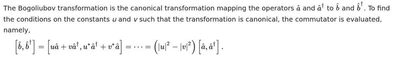

Actually according to various sources, Bogoliubov transformations of the boson operators (not of the states), are symplectic. See for example https://www.cambridge.org/core/book...ansformation/26C26F3B060A025B7550C8B766349F27
This note also says that Bogoliubov transformation for fermions should be unitary (more specifically orthogonal), meaning I have a wrong sign in my starting ##U##, but I would like then to know how to show that.

In the case of bosons, apparently to ensure that the commutation relations are the same for both ##c##'s and ##b##'s. As you noted, for fermions and the associated anticommutation relations this would no longer seem to be the case, because when ##U## has the form given in OP then ##{\rm{det}}\, U = |u_{\mathbf{p}}|^2 - |v_{\mathbf{p}}|^2##, while
