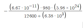

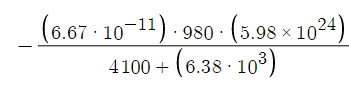

Two Earth satellites, A and B, each of mass m = 980 kg , are launched into circular orbits around the Earth's center. Satellite A orbits at an altitude of 4100 km , and satellite B orbits at an altitude of 12600 km .
Part A
What are the potential energies of the two satellites?
Part B
What are the kinetic energies of the two satellites?
Part C
How much work would it require to change the orbit of satellite A to match that of satellite B?
-G*M_e*m/r
r= km from center of earth which is the altitude + radius of earth
Change in U + Change in K=0
= -3.7298538168*10^13, -2.0594767123*10^13
Ive tried this equation with both masses and my homework keeps coming back with the wrong answer. I've tried checking my arithmetic but I cannot find anything wrong with it please help​
haven't gotten the chance to try B but I am pretty sure it will be the same as A but positive is that right?​

How does the question in Part B differ from part A?
The denominators should be in meters not kilometers.
Thank you that came back correct and part B was meant to say kinetic energy I copied it from the first just forgot to change that part to kinetic.
