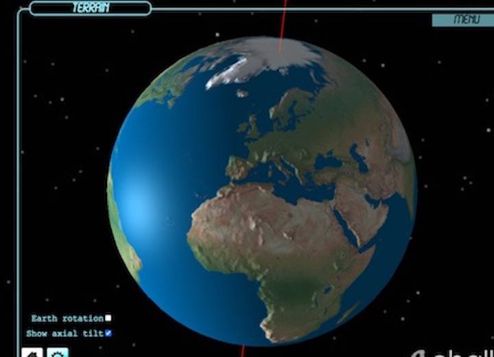

I recently stumbled on a problem I can't solve.
For background, there is a recent story from July 8 about 99% of people receiving sunlight at 11:15 am. Anyone can google it and it's explained fairly well at time and date. There is an illustration. Here: https://www.timeanddate.com/news/astronomy/99-percent-sunlight-july-8
is a region of daylight that accounts for 50% of the globe, with other bands indicating various types of twilight. This daylight region should align nicely with a 3D view of the Earth. Link here: https://www.echalk.co.uk/Science/physics/solarSystem/InteractiveEarth/interactiveEarth.html
Problem is it does not. Try as I might, I cannot get the 50% daylight region to align with the visible parts of 3D Earth. Why?

Yes, its a good article. To be clear, Im not confused about the twilight region. I specified the daylight region. Try to line up the visible daylight region from the first link, with a global 3D map. It just doesn't align.
berkeman said:
I like the fact checking in the first link:
Hopefully, this illustrates the problem. Here is a screengrab from 3D earth. This is one of my attempts to get alignment Notice how it does not align with the 50% daylight region? There are many discrepancies:
It should extend nearly to Antarctica.
It should include more of South America
It should include South East Asia
It should include most of North America.
It does not.
Move the 3Dglobal model about, and the problems multiply. Try it yourself. Why doesn't the visible region align with the Daylight region? Explanation requested. Or if you can get the 3D model to fit the very identifiable parameters of the Daylight regions as illustrated in the link, post a screenshot.

I think the viewpoint in your 3D global view is not at infinity, it is relatively close to the Earth. So it is not showing 50% of the Earth, but less than 50%. As you get closer and closer to the Earth, you see less and less of the area.

1. When you look at the Earth from closer than the Sun, you do not see a full hemisphere because your horizon is closer. The area you see approaches zero, as your height approaches zero.
2. The 99% of population, comes I think from the definitions of the different twilights, when the upper limb of the Sun is 6°, 12°, or 18° below the horizon for astronomical twilight.
You can get to see it backwards from the antipodes, at night, when the two 18° effects of twilight and observer height can cancel. I have not calculated the exact observer height for an 18° encroachment of the horizons, but the cancellation effect is visible.

So you are saying the 3D Globe is not going to show 50%.
Not unless the viewpoint is effectively at infinity, no.

Yes. 50% of the Earth will be visible when the rays from opposite limbs (i.e. diametrically opposed points) are parallel, which only happens at effectively infinity.
What you want is a compromise. Something far shorter than infinity will give you a view of Earth that is fractionally less than 50%.whats your comfort level? 49.9%? 49%? 45%?

It is effectively at infinity..
The rays from the sun hit the north pole and south pole effectively in parallel.
Problem is, from the Sun,the Earth is too tiny to see. You can only see detail when close by.

Because the Sun has an angular diameter of about 0.5°, it has an angular radius of 0.25° which pulls the 180° of the illuminated sphere back to 179.5°, which does not require the Sun to be at infinity.
Yes, the OP doesnt really need infinity.
What they need is a orthographic projection of Earth, not one in 3D.
Plenty of static maps like like but not sure if renderers of that type are very common.

Way over my head, but interesting! Thanks. It does answer my question on why I could not make the map align with the model. I was really perplexed.
