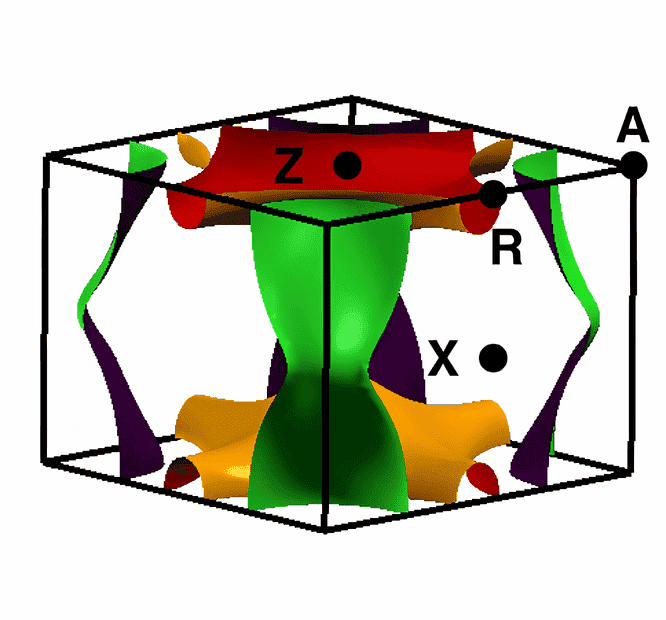

Hi, these are the two pictures. The resolution of the original isn't that good, but it gets significantly worse in the plot
  • Plot of density of states in states/eV on the horizontal axis from 0 to 5, beside a 3D Brillouin zone diagram with labeled high-symmetry points Z, R, X and A.
  • 3D wireframe cube of a Brillouin zone with labelled high-symmetry points Z, A, R and X, and red, green, orange and purple Fermi surface sheets drawn inside it.

What is the final format of the output?
There are certainly artifacts when a raster image is rendered in a different resolution that the original.
Can your gnuplot be rendered in a higher-resolution png to match the original png?
It probably would be better to get a higher resolution original png.
If the original isn't available, one could try a tool like ImageMagick or Gimp to upscale it.
Ideally, you want a vector graphic of the image rendered in your original png.
Alternatively, you could try to manipulate the parts in Inkscape.

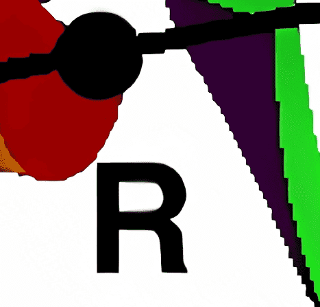

I took your original and fed it https://icons8.com/upscaler (which I just found while thinking about your question).
Here is their upscaled version 3000x2796 (attached)
[actually, no it didn't properly attach... it should be 2.2MB file with resolution 3000x2796 .. see below for an enlarged section]
from your original 484x451.
It may not help that much.
One could seek other methods: like "vectorizing" with potrace
https://www.google.com/search?q=potrace+png+to+svgoriginal:
Fermi surface plot of a crystal Brillouin zone cube with labeled points Z, A, R and X; red, green, orange and purple sheets extend across the zone faces and edges.
upscaled [but PF downscaled it] in the attachment.
Here is a zoom in of a section:
