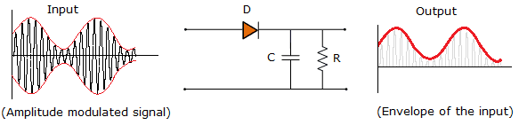

Instead, you might want to consider how an AM detector works. It's basically a rectifier (a simple diode can suffice) and lowpass filter. What is the purpose of the filter? What criteria should the filter satisfy relating to the envelope's peak frequency and the lowest frequency of the modulated spectrum?

In the AM detector circuit, if you look at the signal at a point immediately after the diode, but before the filter, that signal will not look much at all like the original signal, because, although rectified, it still has the high frequency carrier in it. It's the lowpass filter's job to filter out the high frequency carrier part of the waveform.
What if the cuttoff frequency of the filter is too high? What if it is too low?
What if Fp and fs are close together in frequency?

In the figure shown, a simple RC filter is shown. Single pole, RC filters such as the one shown have a rolloff of -6 dB/octave (-20 dB/decade). So if the Fp and fs are close together, what would need redesign to ensure that the carrier doesn't significantly leak into the final output?

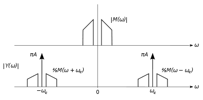

At the very least it's obvious that Fp must be greater than fs, by plotting the modulated signal's power or amplitude as a function of frequency (i.e., by plotting its spectrum).
Plot the original signal's unmodulated spectrum, with frequency on the horizontal axis and power spectral density (or singnal amplitude density) on the vertical axis. Don't forget negative frequencies. Zero Hz is right in the middle, with negative frequencies on the left and positive frequencies on the right.
Don't worry if you don't know the true shape of the original signal. Just make something up. Suffice it to say it has some sort of a shape in positive frequencies, with a peak frequency. The negative frequencies are a mirror image of the positive frequencies.
Now draw the power spectral density (or amplitude spectrum density) of the modulated signal, where the original signal is "shifted up the dial" so to speak, by the carrier frequency, Fp. Something like this (with different variable names):
Now ask yourself what would happen if the orignal frequency's peak frequency was greater than the carrier frequency? What would the spectrum of the modulated signal look like then? Would it not overlap with itself?
That explains why the carrier frequency must be greater than the peak frequency of the original signal. But why must it be much, much greater (">>") as opposed to just greater (">")? The only things I can think of are practical reasons I brought up earlier, such as filter rolloff requirements and antenna length. Other than practical concerns, the carrier frequency only needs to be "greater"; not much, much greater; than the original signal's frequency. Other than that, you might want to skim through your coursework again and see if the material hints at anything more specific [I can't think of anything else].

Do you mean the modulated frequency spectrum?
The modulated spectrum looks essentially identical to the original spectrum, with the following, notable differences:
(1) The center of the spectrum gets shifted up by the carrier frequency; What was once 0 Hz is now the carrier frequency (we're calling it Fp here, although most other books/material call it fc).
(2) It also gets shifted down in negative frequencies too, making the total result symmetrical.
(3) The center of each image (what was 0 Hz in the original image, now the +/- the carrier frequency in the modulated image) contains an impulse representing the carrier.
(4) The amplitude of the modulated image can be different than the original, unmodulated spectrum amplitude. But that's not important for this problem.
My last post has such an image in it, where the carrier frequency is greater than the signal frequency.
