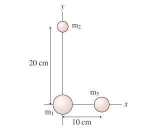

What is the magnitude of the net gravitational force on the m2=5kg mass? Assume m1=25kg and m3=15kg.
https://session.masteringphysics.com/problemAsset/1383524/6/13_P28.png
F=GMm/r^2
First I find the angle between m1 and m2 which is arctan(10/20)=27
Find the force m3 on m2 which is
F23=Gm2m3/0.22^2(cos27i-sin27j)=8.91*10^-9Ni-4.54*10^-9Nj
There also a force acting m2 on m1 which is
F21=-Gm1m2/0.2^2=-2.09*10^-7Nj
the net force, I do Fnet=sqrt((8.91*10^-9Ni)^2+(-2.09*10^-7Nj-4.54*10^-9Nj)^2)=2.137*10^-7N
However, the answer I got is incorrect.
can anyone tell me where I did wrong?
Thanks![/B]
Please clarify exactly what angle you believe you have calculated, then check whether that is the angle you use later in the trig expressions.

the angle is between line m1m2 and line m2m3 (if we connect m2and m3)
Then double check how that relates to your i and j vectors here (j is vertical in the diagram, yes?):

F23 should be Gm2m3/0.22^2(cos27j-sin27i),
I get 2.0*10^-7N, but it still incorrect
Certainly that's not what I get.
Please post all your steps in detail if you want me to find your error.

Here's a guess: what do you get for e.g. sin(27)? Remember to discriminate degrees from radians.

That's adding description, not arithmetic detail. Break this one down:
HaLAA said:
Gm2m3/0.22^2(sin(27)i)=4.6*10^-9Ni(pointing to the right)
I get a different value, nearly 10 times as much.

it is 4.67*10^-8
the final answer is 2.227*10^-7N?
HaLAA said:
it is 4.67*10^-8
Much closer, but you are getting some rounding errors by using the angle 27 degrees instead of something more accurate.
(It isn't necessary to calculate the angle at all - just express the cos and sin values in terms of the given distances.)
Still not what I get for the final answer though. And I don't agree with this:

I plug these number in wolfram get 6.67*10^-11*15*5/0.22^2(0.1/0.22)=4.698*10^-8,
I want to know why -8.9*10^-9Nj(pointing down) isn't pointing down.
HaLAA said:
6.67*10^-11*15*5/0.22^2(0.1/0.22),
The 0.1 is wrong. But even with 0.1 I don't get 8.9*10^-9. I plugged the above into a spreadsheet as 6.67*10^-11*15*5/0.22^2*(0.1/0.22) and got 4.7*10^-8.
It's pointing down.. it's the number I disagree with.

now I think I get all right number, Fnet=sqrt((4.698*10^-8Ni)^2+(-2.09*10^-7Nj-9.369*10^-8Nj)^2)=3.07*10^-7N
I get 3.01*10^-7. You lose accuracy by calculating intermediate results and plugging them back in later.
