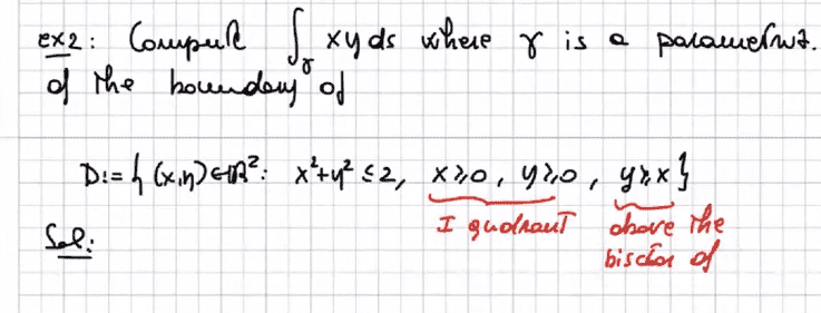

My question is: is it possible to use the green theorem to compute the circulation while in presence of a scalar function ? I know how to solve by parametrising each part but just in case we can go faster? thank you!
Handwritten exercise: Compute the integral over gamma of xy ds, where gamma is a parametrization of the boundary of D = {(x,y) in R^2 : x^2 + y^2 <= 2, x >= 0, y >= 0, y >= x}, with annotations 'I quadrant' and 'above the bisector of'.

I could be wrong, but I don't believe that Green's Theorem is a reasonable approach here. It seems much more straightforward to parameterize the boundary into three curves, and then evaluate the integral of each.
Going counterclockwise along ##\gamma##, we have
1. ##x = t, y = t, 0 \le t \le 2##
2. ##x = 2\cos(t), y= 2\sin(t), \pi/4 \le t \le \pi/2##
3. ##x = 0, y = t, 2 \ge t \ge 0##
