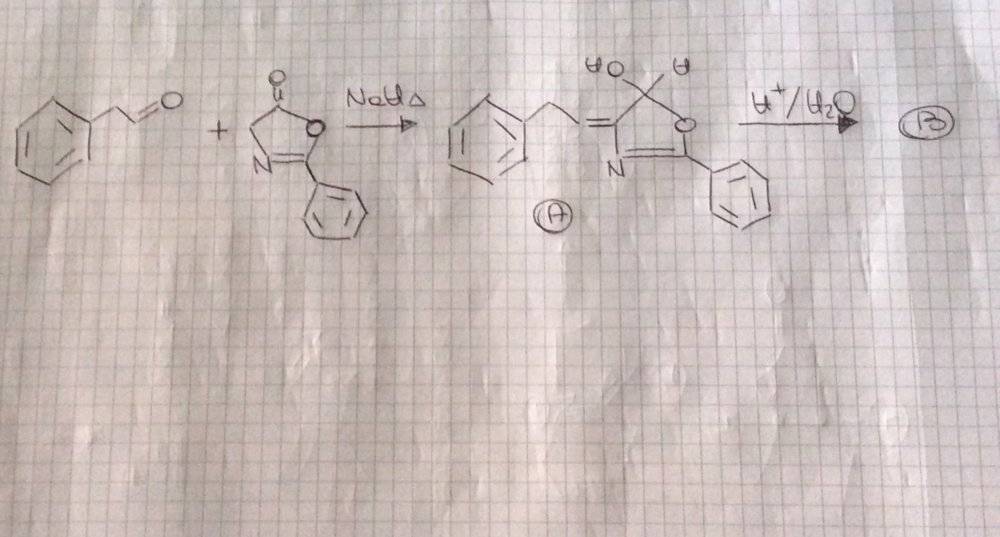

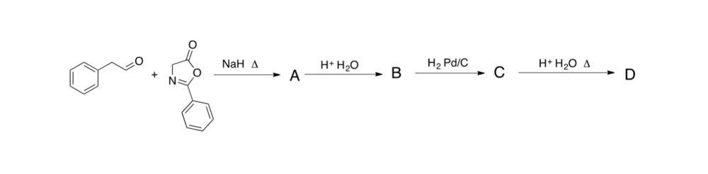

I need to find the molecules A, B, C, D from the following guided reaction.
I can’t get past A...I did the aldol condensation for A, but then I’m stuck at this point...I can’t figure out how to go on from there.
I think your first step isn’t right. What happens to your reagents when you add sodium hydride?
