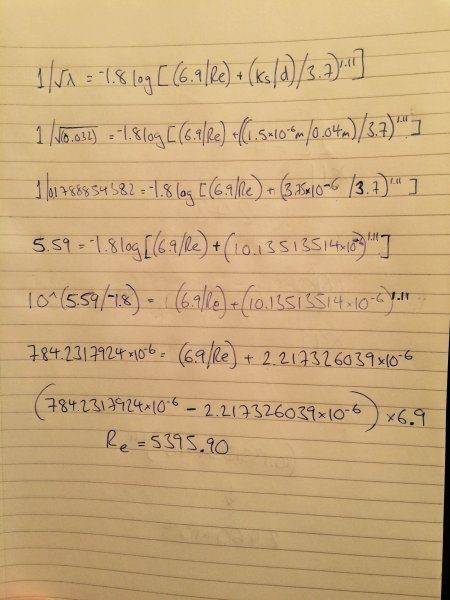

I had a go, see what you think: -
For the term (1.013513514*10-6)1.11, I don't get 2.217326039*10-6. There's some calculation mistake here, as I checked the result also using logs.
Remember, the Re you calculate must also work when you substitute this value into the original equation. This is a way to check your calculations.

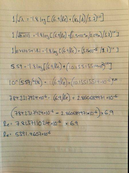

Yeah, I calculated it wrong by the looks of things. I've tidied up again and it's more in line with Kinggy above. Also, I have been using the ENG button to keep it uniformed to x10-6
The previous calculation is fine until you reach the last couple of lines, and then your algebra breaks down.
What you have written here is fine:
784.23179*10-6 = (6.9/Re) + 2.86069*10-6
which should then be simplified as:
784.23179*10-6 - 2.86069*10-6 = 6.9/Re
781.37110*10-6 = 6.9/Re
Now, what should be done here is to multiply both sides of the expression above by Re to give:
781.37110*10-6 Re = 6.9
and solving for Re then gives:
Re = 6.9 / 781.37110*10-6 = 8830.6, say Re = 8831.
This value of Re, when plugged back into the original Haaland equation in the OP, should then satisfy both sides.
Thanks very much, I understand it now. thanks for teaching the thought process.
