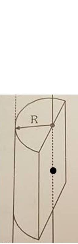

Hi. in my problem there is an infinite half cylinder uniformly charged with ρ.
What is the force is the cylinder is making on a test charge on a charge located on the position that is shown on the following picture:

In my attempt I tried to divide the half cylinder to half circles and to sum them from z=-inf to z=inf
Something is going wrong with my calculations, and I have few questions:
1. The force on the charged because of symmetry is normal to the part of the cylinder that is cutted (x axis)?
2. I tried to use cylindrical coordinates:
so dV= rdrd(theta)dz
so r [0,R]
theta [0, pi]
but z is [inf, -inf], doesn't it mean that the force will be endless?
  • Diagram of a half cylinder with a dashed vertical axis, radius R marked by an arrow from the axis to the curved surface, and a black dot with a dotted vertical line below it to the right of the flat face.

No, it doesn't mean that. You know that the electric field from an infinite line of charge at some distance ##r## from the line is finite. Have you considered adding infinite lines of charge to form the cylinder instead of adding half-disks?

Your area element ##dA=2\pi r## is not correct. That's the circumference of a circle of radius ##r##. What is your Gaussian surface? What is an element of area on the surface? Also, you need to write integrals correctly. The form is ##\int f(x)~dx##. If you are integrating over the radius, you need a ##dr## the presence of which you must justify. Hint: It's related to writing ##dA## correctly.

Your calculation in post #3 for the electric field due to an infinite wire correctly gives ##E=\frac{\lambda}{2\pi \epsilon_0 r}##. The question is what do you use for ##\lambda## if you know ##\rho##? Remember that in cylindrical coordinates a charge element is ##dq=\rho \ dV=\rho~ rdr~d\theta~dz##. The linear charge density is ##\lambda = \frac{dq}{dz}##.

You didn't get it. You are integrating the magnitude of ##E##. Vectors are added by adding their components. You have to integrate the components of ##E## separately to find the total and hence the field vector.

As ##\theta## changes you must add together the components parallel to the face of the half-cylinder and separately add the components perpendicular to the face. This means two separate integrals. Your expression in #16 has a vector on the left side and cannot have a scalar on the right side. You need to rethink this and come up with two equations,
##E_{\parallel}=\cdots##
##E_{\perp}=\cdots##
One of these (which one?) should integrate to zero.
