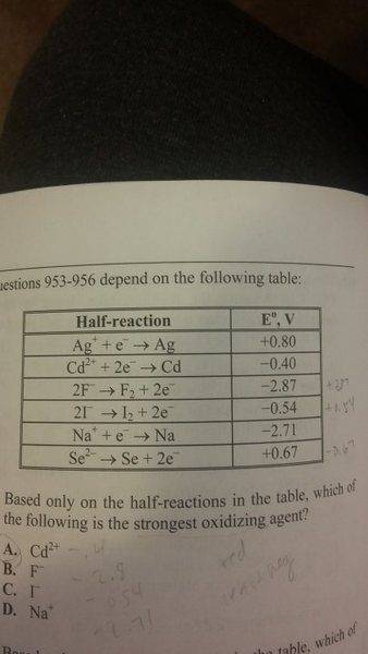

Based only on the half-reactions in the table, which of the following is the strongest oxidizing agent?
(See attachment)
I noticed in this table that not all elements are in the reduction form. I flipped them around and changed the sign, however, the correct answer states that Cd2+ is the correct answer. Shouldn't it be F-? Thanks in advance.
  • Photo of a printed table of standard reduction potentials (E° in V) for half-reactions: Ag+ to Ag +0.80; Cd2+ to Cd -0.40; 2F- to F2 -2.87; 2I- to I2 -0.54; Na+ to Na -2.71; Se2- to Se +0.67, with handwritten notes beside the values.
brake4country said:
F-?
... an oxidizing agent?
Ok, I typed that wrong. According to the chart, we know that the the half reaction: 2F-→F2 + 2e- has potential of -2.87 V. But this is being oxidized. Don't we have to flip it and change it to the reduction half reaction to compare it to the rest of the agents listed?
No. F/F2 is an oxidizing agent; F- is a reducing agent.
Right, so wouldn't so wouldn't 2F-→F2+ 2e- be the strongest oxidizing agent and not Cd2++2e-→Cd? I think the book is wrong in this one.
NO. The half reactions are written with both species; you are not being asked to pick a half reaction, just a single species.
