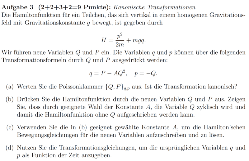

ardaoymakas
3b) Print out the Hamilton function using the new variables Q and P. Show that by choosing the appropriate constant A, the variable Q becomes cyclic and therefore the Hamilton function can be written down without Q.
H = (p^2/2m) + mgq
q = P - AQ^2 , p = - Q
I took the derviative of the Hamiltonian function with respect to Q and assumed that it was equal to 0 in order to find the Konstant A. I did find the Konstant A as -1/2m^2g but I still cant write the Hamiltonian equation without having the Q as a variable. Can someone please help?
Translation:
The Hamilton function for a particle moving vertically in a homogeneous gravitational field with gravitational constant g is given by
We introduced new variables Q and P. The variables q and p can be expressed by Q and P using the following transformation formulas:
a)Evaluate the Poisson bracket {Q ,P}q,p. Is the transformation canonical?
b)Print out the Hamilton function through the new variables Q and P. Show that by choosing a suitable constant A, the variable Q becomes cyclic and therefore the Hamilton function can be written down without Q.

Hey,
Thanks! Is this better?
I've never worked with Hamiltonians, so not usually able to answer such a question, but it seems to me it is trivial to find the A which eliminates Q (and yes, it is the A you found). Just write out H in terms of P and Q. What does the Q term look like?
Edit: I see you have a sign error.
haruspex said:
Much better, thanks.
When I write it in terms of Q I get H = (-Q)^2 / 2m) + mgP + (Q^2)/2m which isnt the formula without Q
Did you note my edit? It says your expression for A has the wrong sign.
